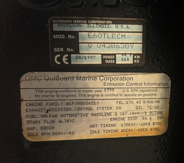

E60TLECM carburetor question and differences 60/70hp 1998 models

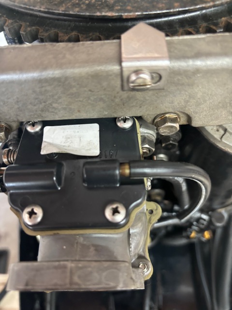

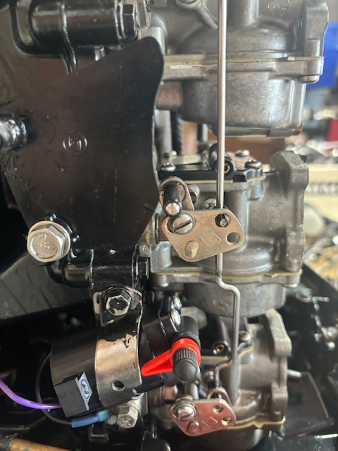

One set of carburetors does have three holes entering the throttle body and the others has five for fuel delivery into the motor. Any thoughts about this?
Post pictures of the 3 / 5 holes.-----This is a 3 cylinder motor ?
Yes, carbs are cleaned now. The holes are at the top of the carbs under the plastic cover for the choke fuel delivery at start up, enrichment from the electric choke.
