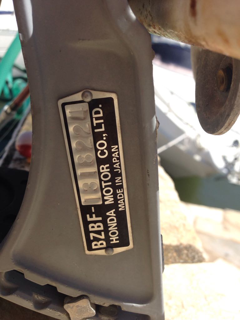

sorry is 2007. Here is a picture of the makers plate and as you can see it's actually a 2hp motor. Can't beat Honda efficiency eh? :confused:

That is not the revised sensor in you photo,the revised sensor takes a 14mm spanner, that one takes a 22mm. The revised sensor also screws into a reducer, I will check the ECU part number for you tomorrow morning so that you can see which ECU you have and confirm which sensor you should have, your engine is an A6

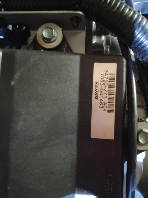

My 2007 (but apparently its a 2006 model) 225 has had the ECU and sensor update - in order to work with the updated sensor the ECU part number is 34750-ZY3-A04.
Not a good pic but I think you can see the smaller diameter sensor screwed into the reducer:
As you see from metal chicken's photo, yours does not appear to have been upgraded, check your ECU part number and then take it up with Honda customer service if it doesn't match

The sensor you are looking at in my opinion is the correct one for your ECU, however, it has a 10mm thread whereas I believe yours has the original 14mm thread necessitating the reducer as shown in metal chicken's photo, not sure how your sensor has worked with that ECU in the past because it is the older original version used from the inception of the 225.
The two shown in the pic side by side are the one removed with some force and the replacement. No adaptor. The new manifold (fortunately) ordered from Lings and the new sensor from the same location are the latest available according to Lings. The ECU nuber fits the new ECU so not sure where you're coming from there Ian? Everything is indentical.
The correct part number for the sensor that should be with your ECU is 35655 ZY3 C01 which matches the one you found at NGK and is the one that you should be using with that ECU, that part number is the latest and is common to all 225's back to the A6 assuming the A6 has had the new ECU and O2 sensor upgrade.
