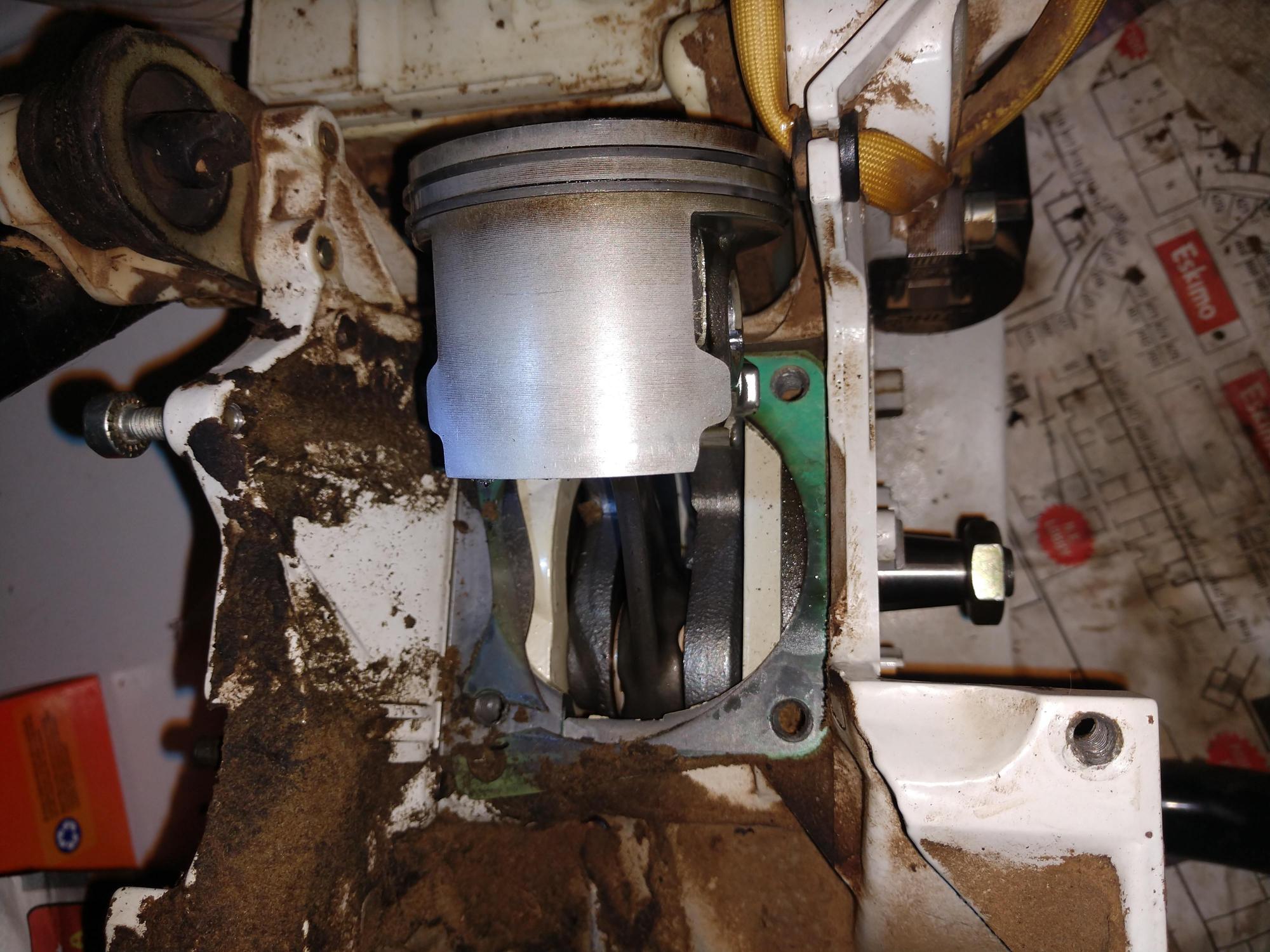

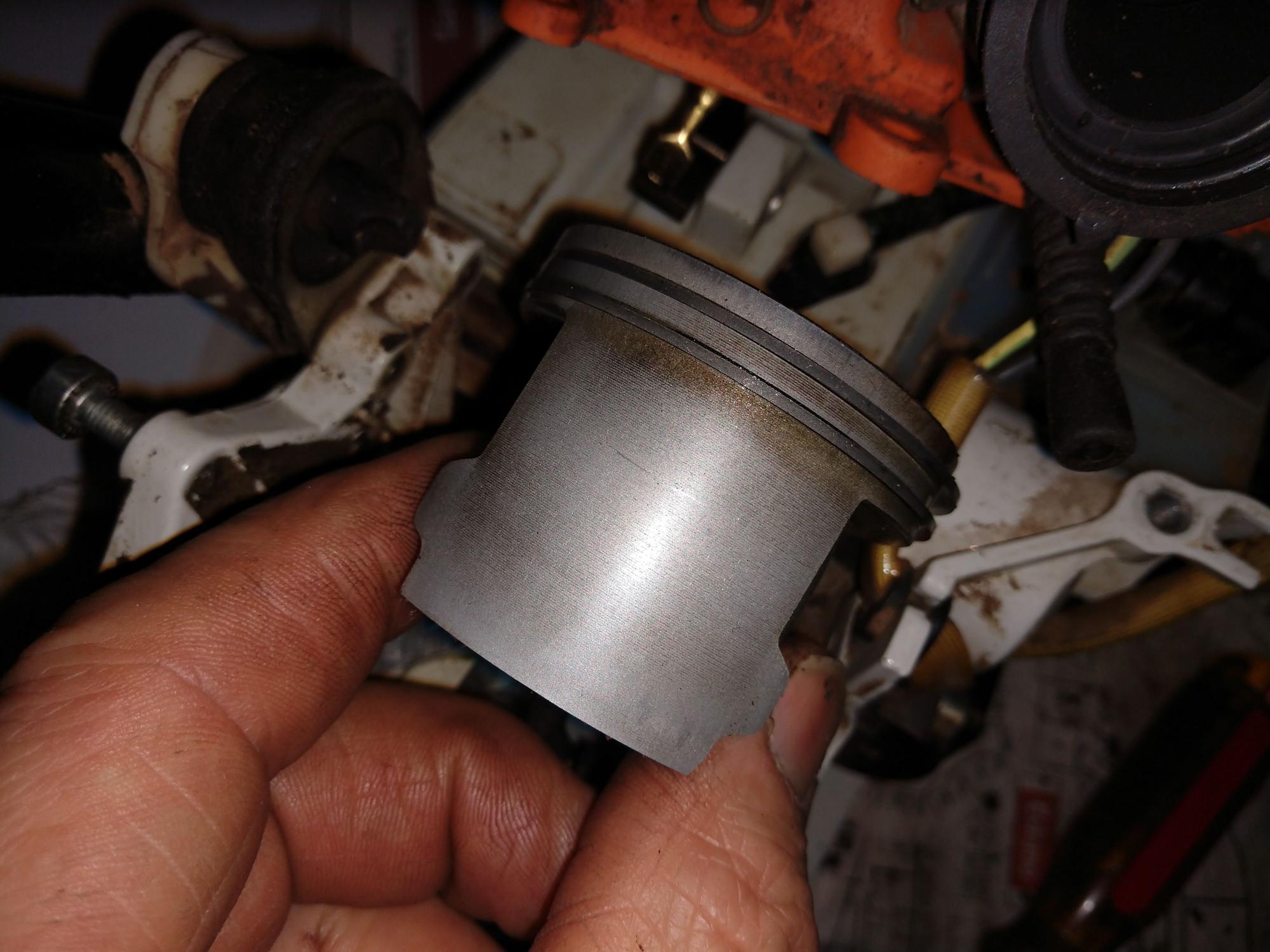

How about this jug/piston on my Stihl MS660? 17 years old and hundreds of cords of oak, diced to 16". You be the judge.
