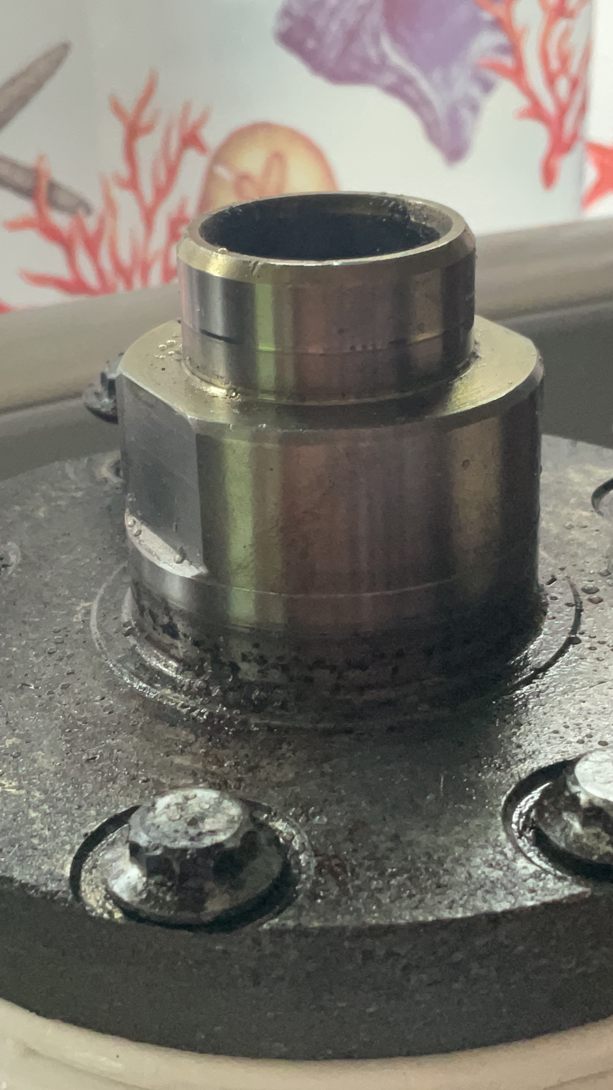

Had oil coming out of the starter and front clear tube. Took the day and removed the power head. Had oil under the power head. 2002 130 hp. Thanks in advance.
And are they the ones in the oil pump? TuHad oil coming out of the starter and front clear tube. Took the day and removed the power head. Had oil under the power head. 2002 130 hp. Thanks in advance.

Not sure I'm understanding but items 15 and 16 in the link below are the pump seals.
gHonda Outboard 130HP OEM Parts Diagram for OIL PUMP | Boats.net
Buy OEM Parts for Honda Outboard 130HP OIL PUMP Diagramwww.boats.net
Items 11 and 12 in link below are the crankshaft seals
Honda Outboard 130HP OEM Parts Diagram for Crankshaft Piston | Boats.net
Buy OEM Parts for Honda Outboard 130HP Crankshaft Piston Diagramwww.boats.net
As to my opinion, I recommend changing them since you're there although, I also think you're wise about looking into those bolts the guy posted about. I would change those too if I had come this far.
It all falls under a heading named:
"How Many Times Do I Want To Take This Apart" ;>)
If that's wasn't what you were referring to, apologies.
Will do Thank uI do recall a few years ago someone(probably hondadude) advising that the oil or water gallery plugs under the engine block on the BF130 are susceptible to leaking, & should be replaced or resealed if the power head is removed for whatever reason.
Bob
Good stuff Thanks for everything! I keep u updated.Hondadude is my all time favorite on this site! If HE said it, then it should be done.
Yes, get new gaskets and seals and file the small expense under
"Cheap Insurance".
