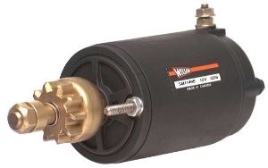

Found this in Another thread: A-50-47216A2 is the part number of the discontinued starter for 1970 -71 and -72
Could this work?
