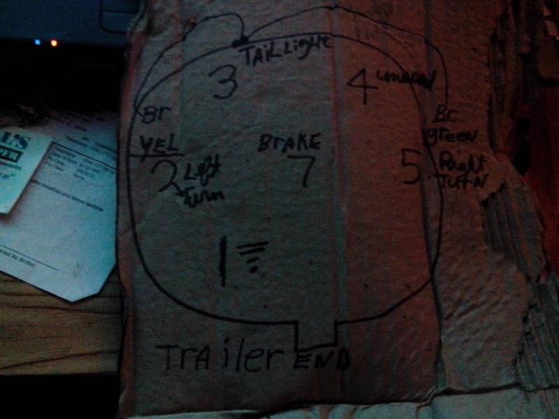

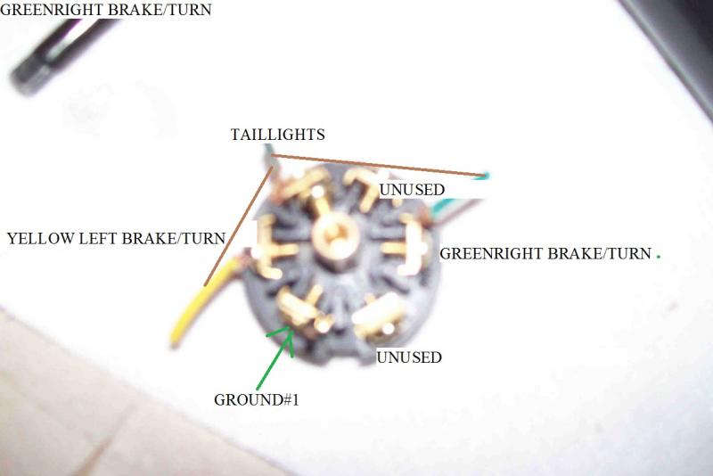

I have a 7 pin round tail/brake/blicker/anti brake reverse all I can manage to get working are the right/left brakelight/blicker can’t get the taillights on.
Here’s what I’ve connected all from trailer end plug.
pos1- ground black
pos7 trailer antireverse lockout. black
pos5 green
pos2 yellow
Pos3 tail light brown from yellow/green
I do have continuity on my wiring, and I’ve checked all the fuses under the seat all have continunity.

the big spade part of the second part of the OEM coupler was covered w/ about 50% rust attach image I scraped w/ screwdriver and sparyed soaked in CRC electronic cleaner.

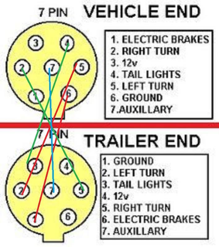

The first diagram scares me to some extent......
first off, you need the tow package to get full functionality out of a 7 pin connector on the truck -
second, I'd suggest you use a battery and a couple jumpers and verify the trailer wiring - for colors and integrity....not everybody uses "the standard"
Then, verify the desired functions on the truck and note their location(s) on the connector pins
Ideally, the "color standard" will have been followed and the pin utilizations as well...if not, one side will have to have wires relocated to match the other.
The benefit to using the 'standards' is knowing the hookup will work the first time you plug things together.
Finally, to remove ambiguity, one typically has to specify the connector orientation on a pin out diagram as things get mirrored when you look "from the other end".

there are a few things since initial 7pin trailer end plug was installed. first I restripped the wires exposeing 2" of bare wire then I did the haywire twist around the securing bolt then add the squared washer I certainly have a secure electrical conncetion.
been getting conflicting infor about trailer end pin # 1 O'clock position power I'm not sure if I don't need power on this pin I think I don't because there's nothing on the trailers end to power or am I missing something here?
I don't have power on pin #1 O'clock position car end.
each tail lights grounds come from trailer end pin # 7 O'clock I added a extra ground from the trailers frame the taillights will hopefully function will the extra ground interfer w/ the pin #7 O'clock connection
