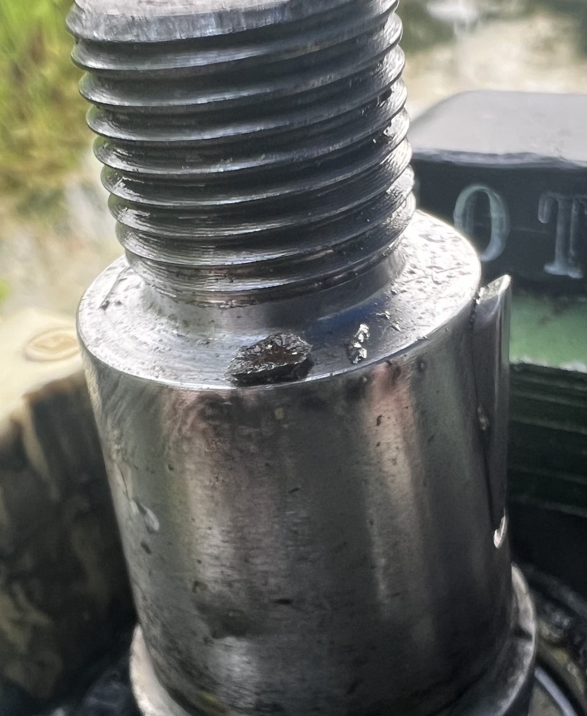

I pulled the flywheel. Here are some pics:
The flywheel key seems fine. At first i thought it was worn, but after looking at the tapered slot in the flywheel i see that it appears to be correct.
As i mentioned previously i changed out the charge coil assembly. I believe everything went back together correctly, but does anyone notice anything a miss?
Close up pic of flywheel key in position.
When you put fuel directly into the cylinder , it should ROAR LIKE AN ANGRY LION for a second or more.----Switch plug wires and repeat the test.----Orange / blue stripe is for the top cylinder.
Ok key is there not sheared.
Like Raceone said it should fire. You have spark but obviously it's at the wrong time. Swap the leads like he said. If that doesn't do it then maybe you installed incorrect parts?
