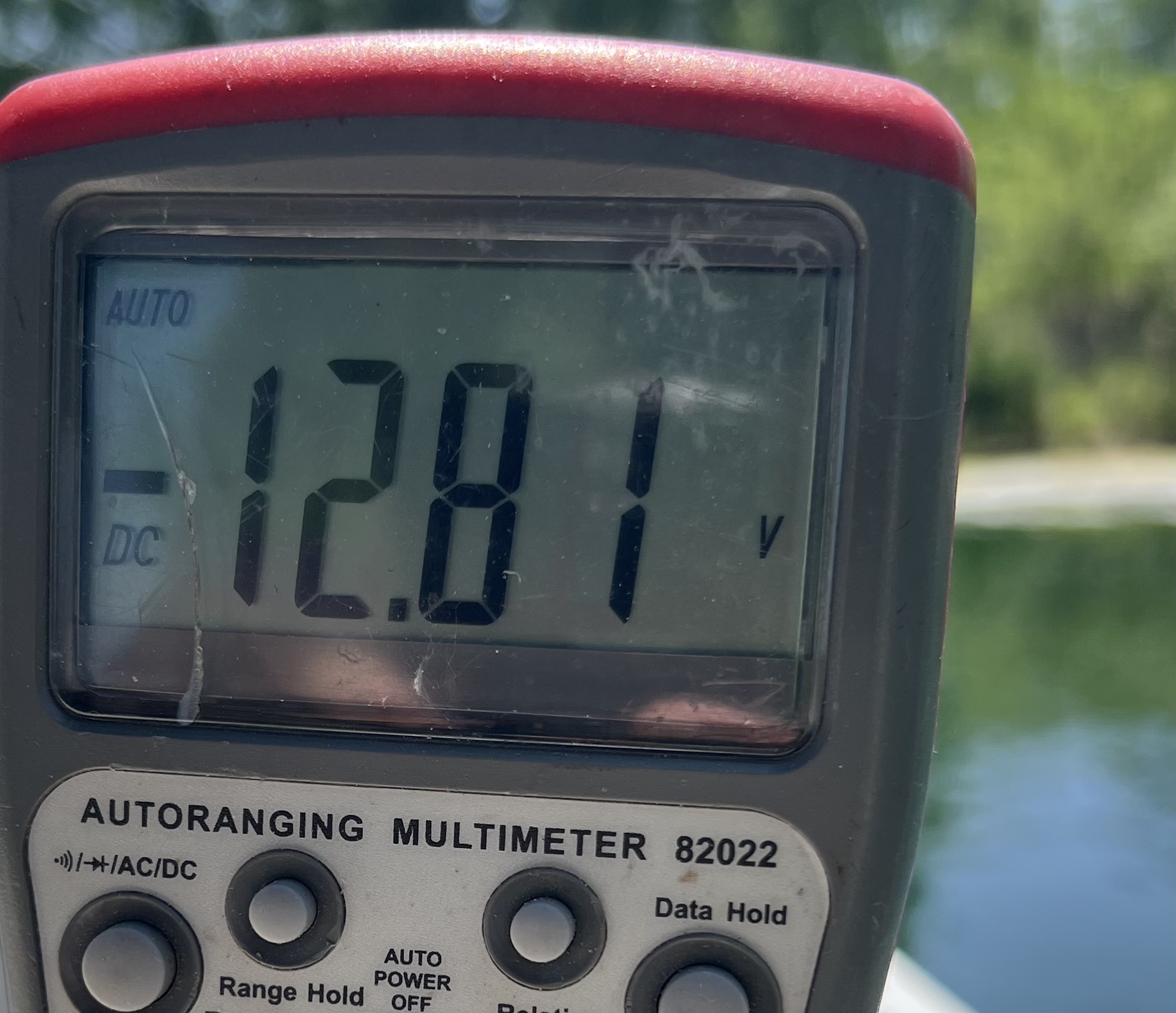

I will do a compression test in a day or so. Meantime the flywheel key was fine, during the removal of the flywheel, when i installed a new charging coil. I had to use a puller to properly remove the flywheel. I tested the charging during todays voyage. Two pics showing a voltage increase:
Photos too big. I will remedy the file size.
This is the starting voltage.

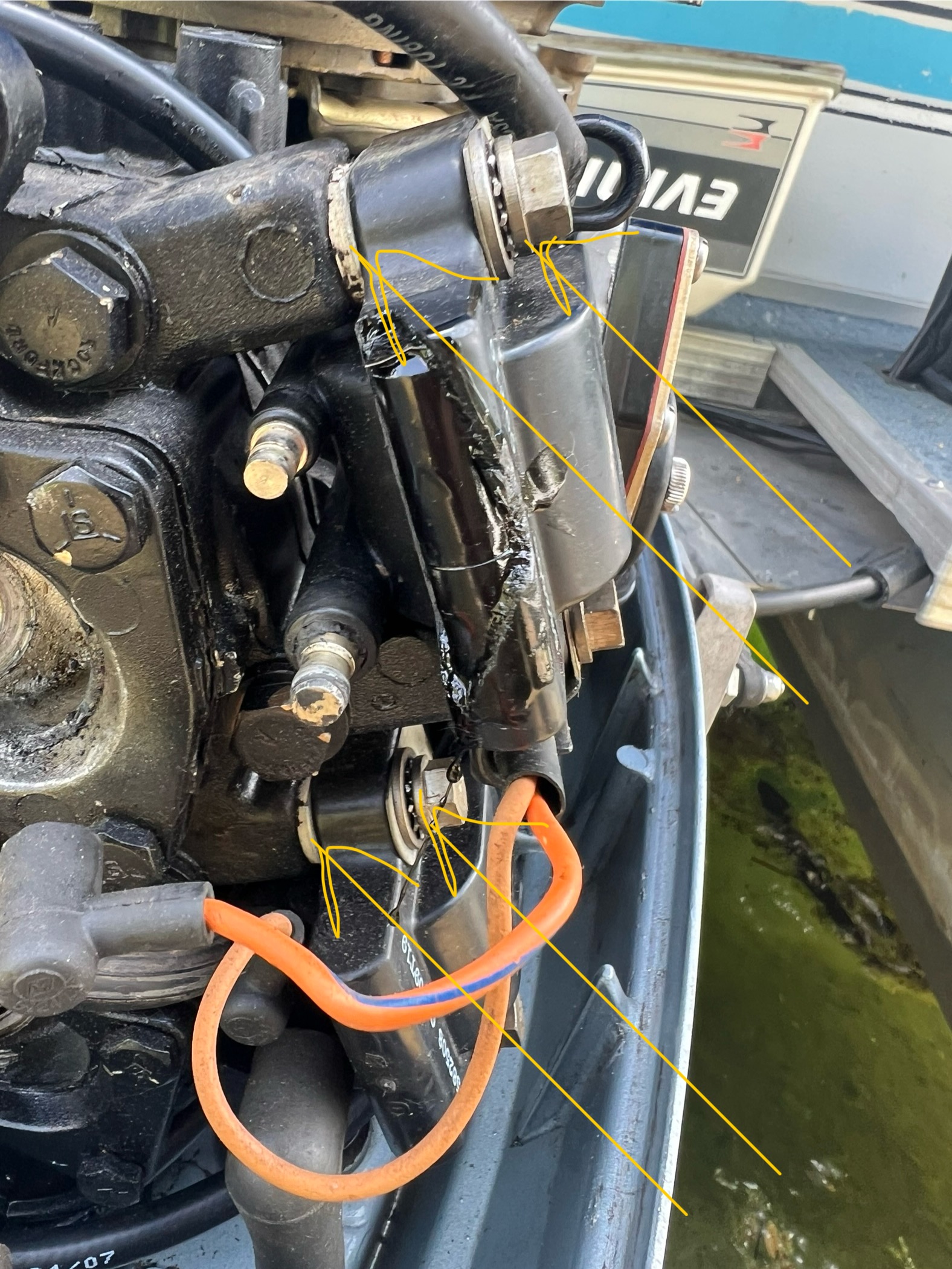

Also another observation: one ignition coil seems to have gotten hot and had some black tar stuff melt / ooze out. Does this provide any clues?

I received my new parts (ignition coils, spark plug wires, and CDII module).
I noticed the coils need to be grounded as per the wiring diagram. The upper mounting bolt should connect the external ground strap of the coil to the side of the engine (ground).
However after reviewing my pics prior to disassembly, i see there are two fiber washers on each coil , preventing the external ground straps on the coils from contacting the ground of the engine housing.
I have attached a pic.
I think these fiber washers need to be removed, so the coils can be grounded.
I bought this boat and engine combo in 2020. The engine ran fine (?), until last fall 2024.
I dont see how i was getting spark before with out the ignition coils being grounded.
I must be missing something... Steve
The star washer and the bolt head bite into the ground strap on the coil and provide connection to the block through the bolt.
Kevinj, i completely agree with your statement. But in my case the fiber washer (non conductive), stops the star washer and bolt from contacting the strap on the coil. I believe i need to remove the fiber washers so the coils can be grounded.
I dont see how i had spark previously???
