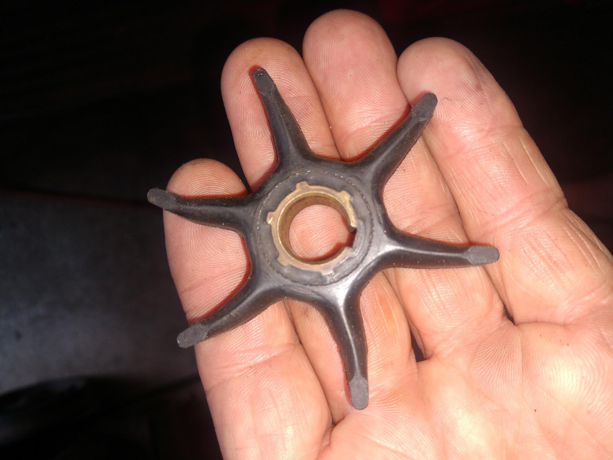

Back in those days we had REAL rubber. This stuff now is garbage. My 1954 Johnson 5 1/2 Sea Horse has the ORIGINAL IMPELLER. I use it regularly. Don't want to put in a new impeller because they are crap. Here is a 56 year old impeller I recently replaced from a 18 hp Johnson. It's still perfect but customer demanded replacement. The new one is not as reliable as this one here. It's sad, my friend. IMG_20200724_100403465_compress44.jpg

One difference is brass vs plastic key slot/ crank shaft adapter. Everyone seems to have their way of dealing with the water pump. Personally, I don't fix it if it works....just asking for some other kind of trouble. Course I boat in protected water, maybe 5 miles the longest trip on calm days in man made lakes, no salt water, no long trips out into the ocean, no paying customers.
I guess a few ounces of brass is too costly to include in the engineering on a $25,000 outboard. I boat in remote NW Ontario where a mechanical failure could lead to huge problems. I run twin motors, even though I am ultra careful and test my equipment regularly. Born and raised in remote territories. Been there, done that, still do it. Stupid.....maybe, but at least if something breaks, I know who to blame.
If you use the EMP brand impeller you will be getting the SAME impeller and rubber used 50 years ago. Winston and his crew made the impellers for OMC and has branched off into other brands. They also make the OEM carb kits for them.. I use EMP and Seirra all the time. Mallory,GLM and several other use a softer rubber which actually helps in pressure. A Mallory impeller in a Johnson V4-V6 will picked up about 2 psi at idle and 4 psi at WOT..
Excellent information Pappy, thanks. It's obvious you and I are still actively repairing. Just wondering if the rubber compositions have been modified to reduce costs? Pure rubber is expensive. Latex comes from over 200 kinds of plants, but the real....good stuff.....comes from rubber trees (Hevea brasiliensis), found almost exclusively in the far East.
Just to all another note.......even Coca Cola modifies their recipe......based on what the public seems to like. I know, I used to work for them.
I really don't have the longevity in my impellers like the sample in my hand from the old 60's 18 hp. Once replaced, even with the new OMC impeller......just like the one I put into a 9.9 last night......I expect it to fail in under 10 years time......I can almost guarantee it. Been "playing" with outboards as a business since I rebuilt my first Johnson in 1966.
