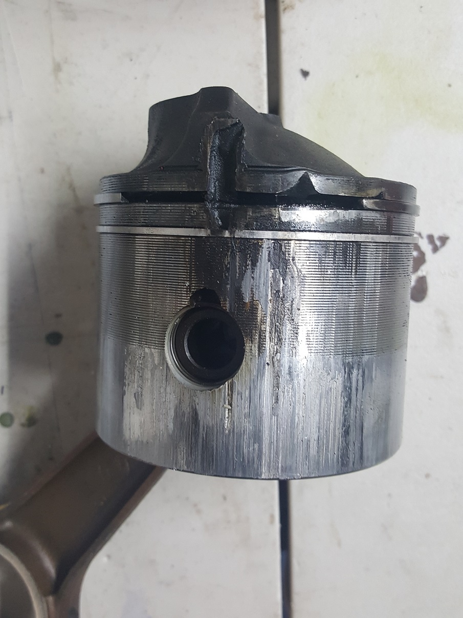

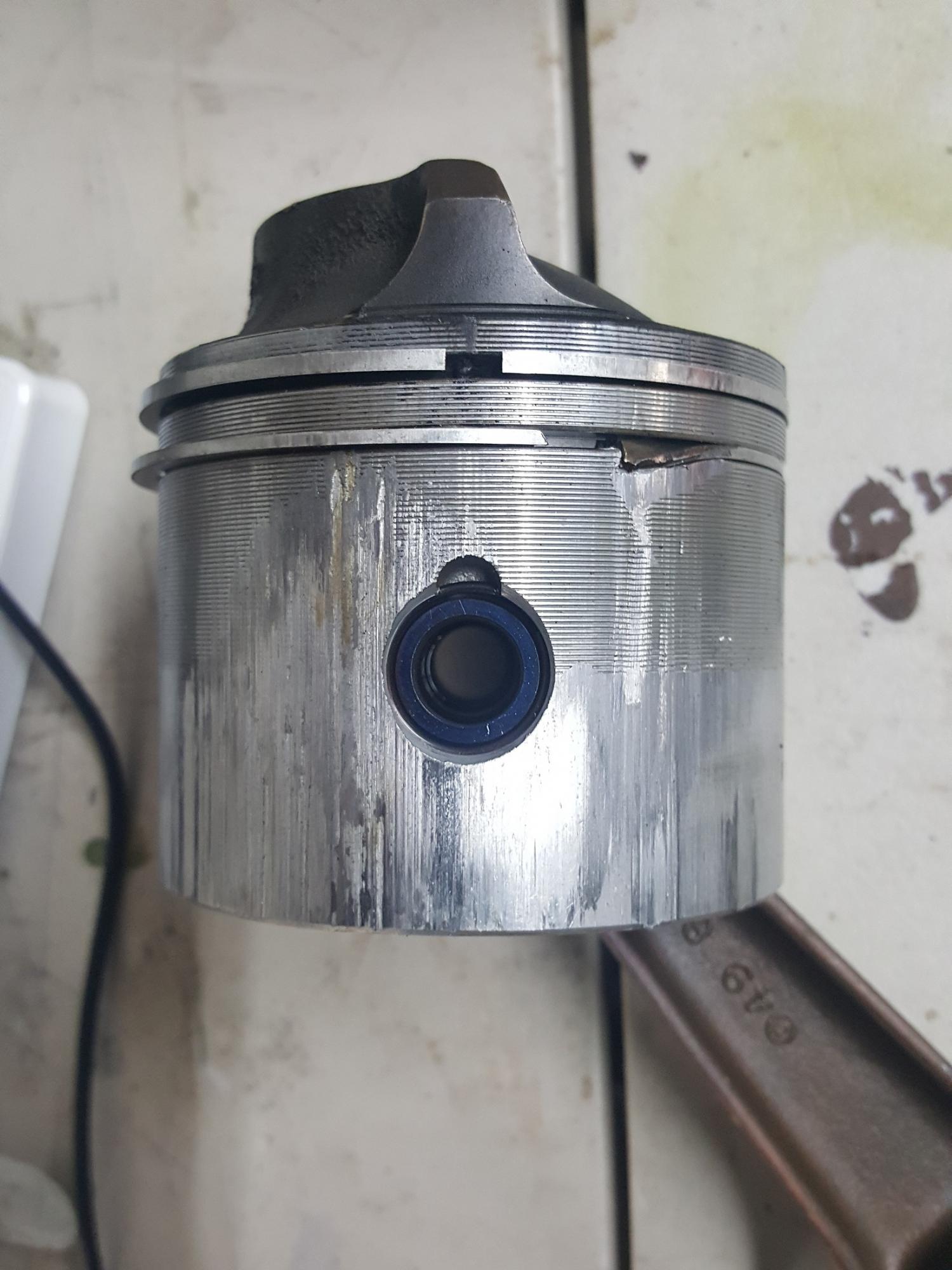

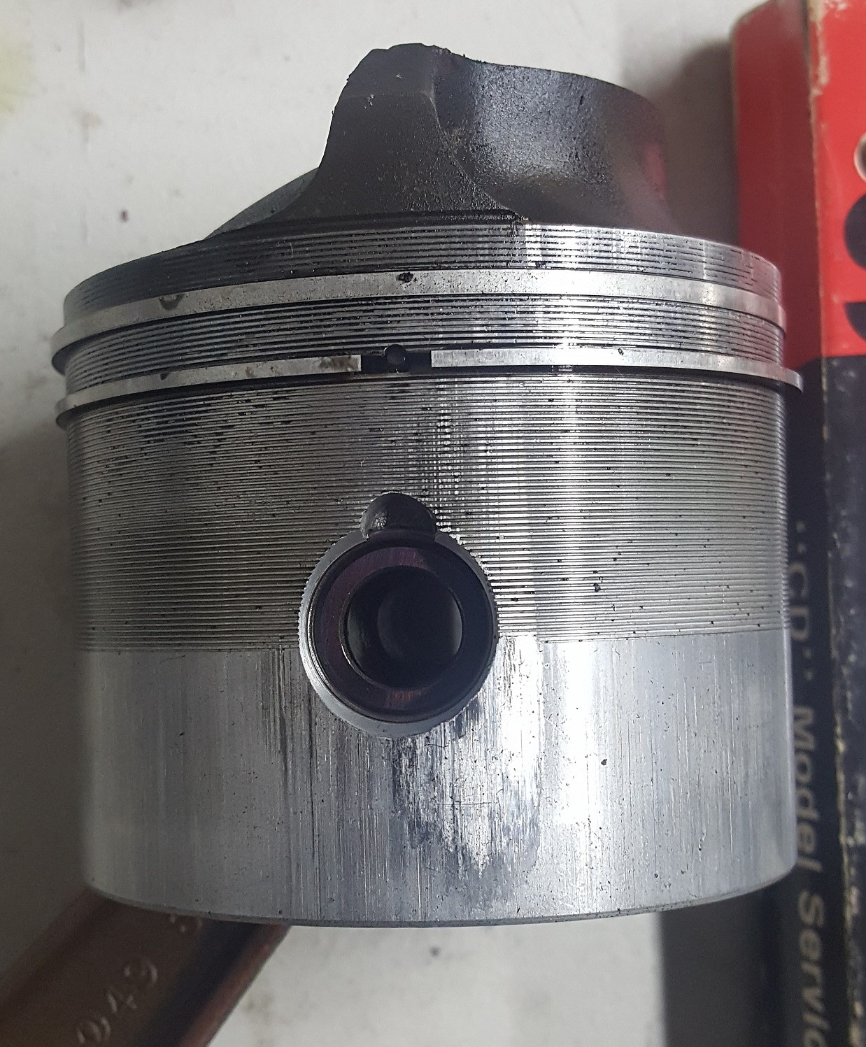

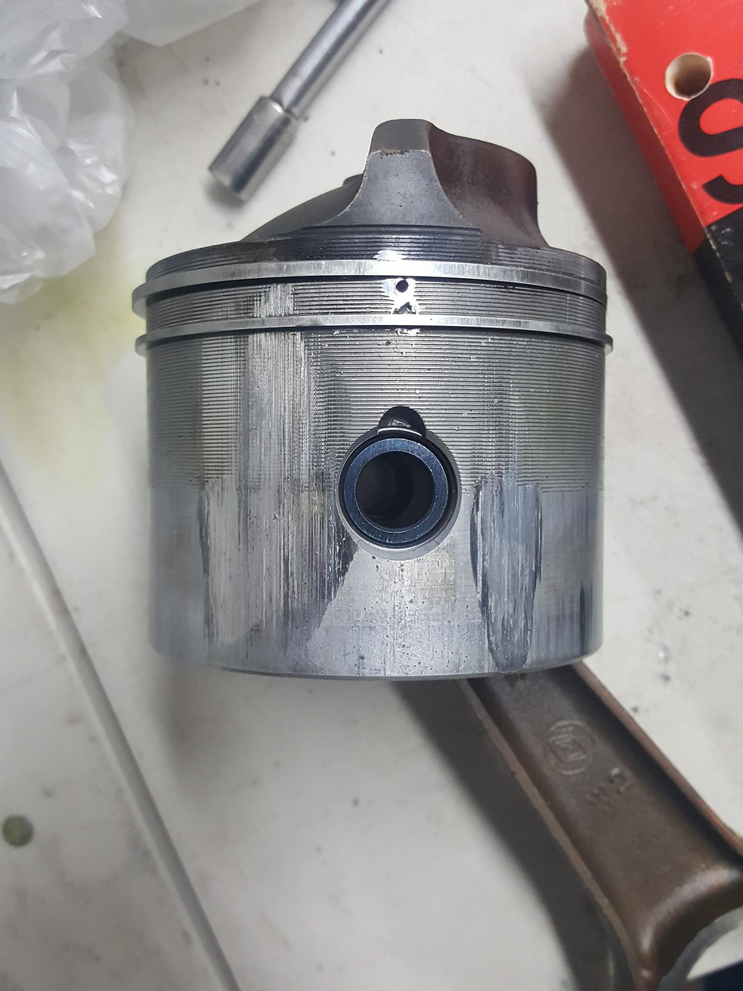

I'm still looking for a clue as to why the damage occurred.

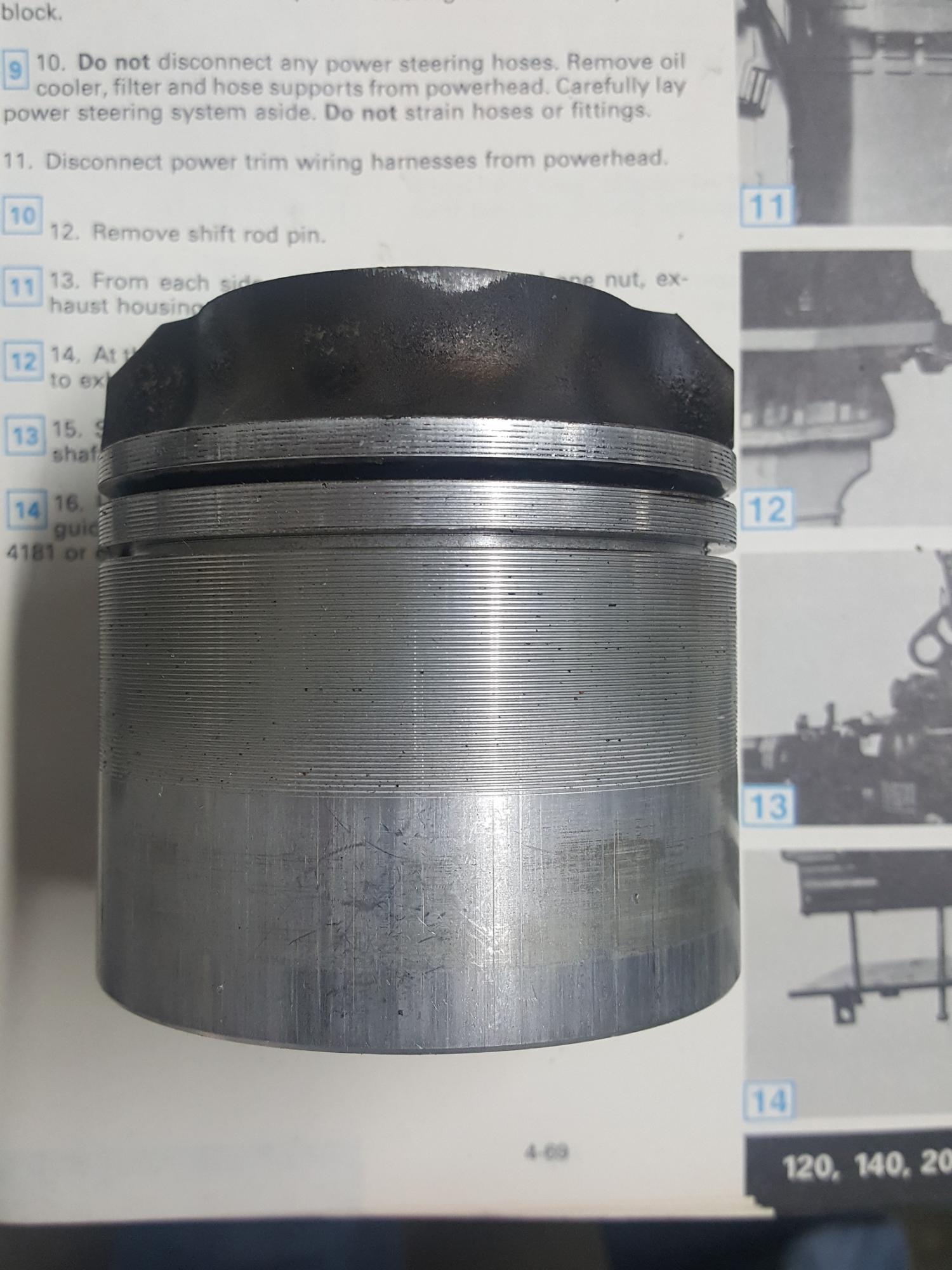

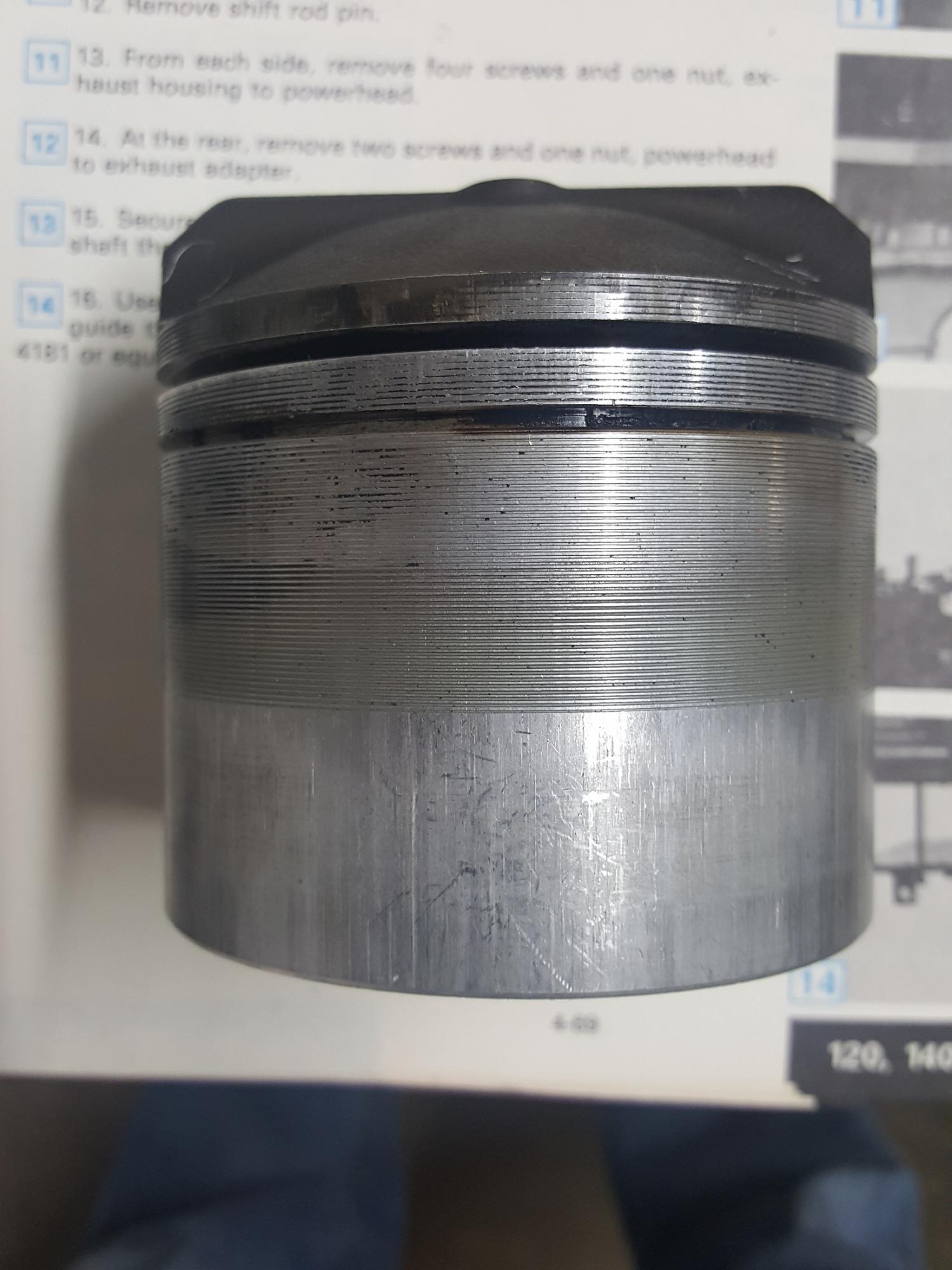

Sharp eye to spot the 120 / 140 pages on the work bench.----Any more pictures of those 2 pistons and the other 2 pistons.------The color marking on rod was not due to anything inside the running motor.----More piston pictures needed.

Here is piston #1, the only piston with no damage. At 1/4" from bottom of skirt it measures 3.495 parallel to the wrist pin and 3.491 perpendicular to WP.

No way. That wasn't the cause. She got hot and lack of lubrication. Perhaps the same problem surfaced after the backyard overhaul.
The #1 cylinder has no damage while 2 and 3 suffered badly.
Do the OMC V4's have uneven manifold distribution or get less coolant where cylinders 2 and 3 run hotter? Interesting that the three pistons got that hot while #1 was pretty much unscathed.

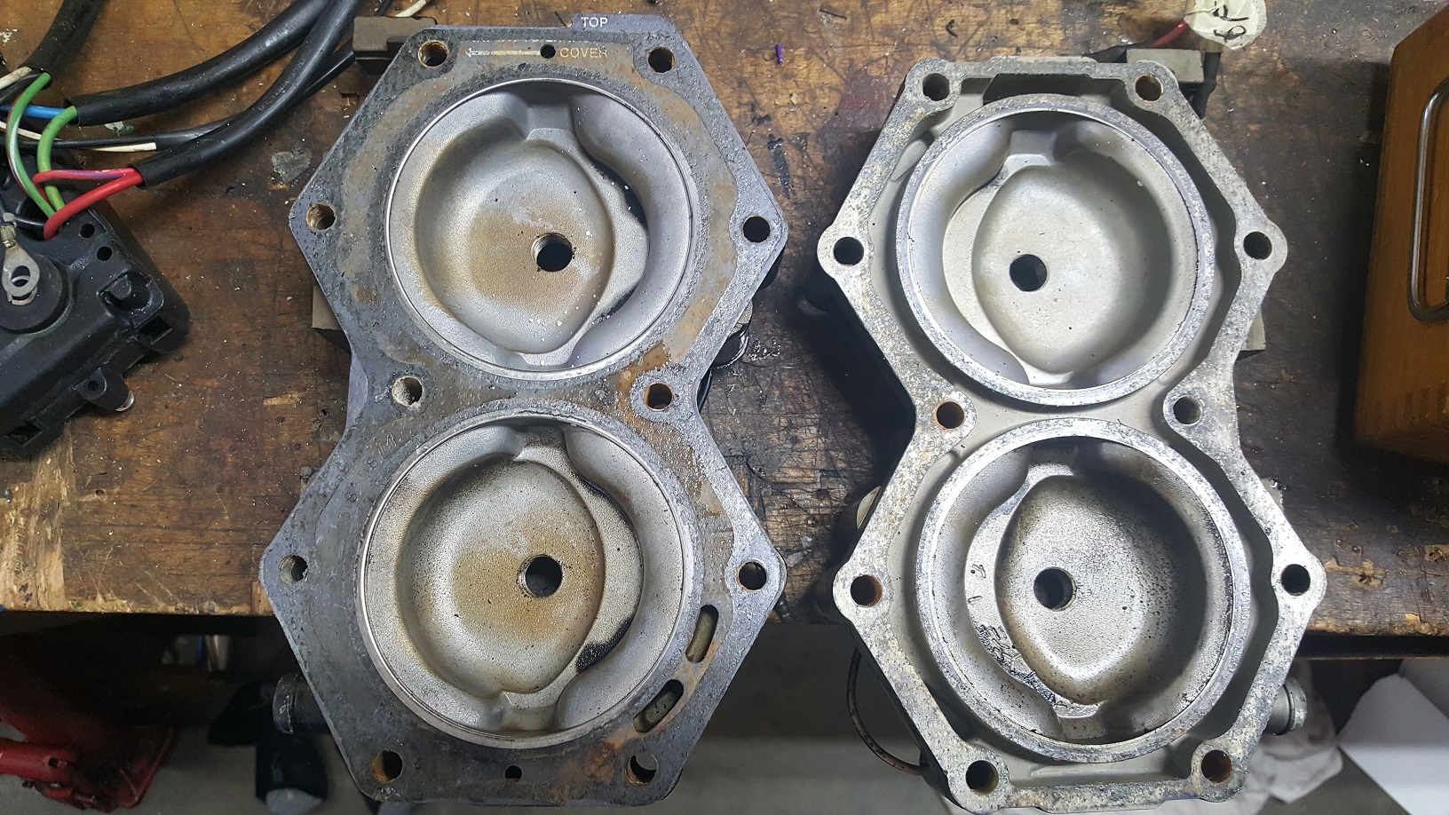

The #2 is top on port and #3 is bottom on starboard.----@ different thermostat / poppit valves in the picture.-----Were the head gaskets on correctly , yes , no , not sure ?
The gasket is still stuck to the port side cylinder head, picture attached. Keep in mind that will I have built and rebuilt many types of engines, both 2 and 4 stroke with good results but I have no previous experience with outboards.
The factory manual says "install head gasket per instructions on gasket" but does not offer any pictures. In the attached picture you will see the port head gasket says "Cover" with a directional arrow. If the arrow should be pointing towards the engine cover then the gasket is mounted incorrectly and I can see how coolant flow would be affected. The gasket on the starboard side is off and I did not notice how it was installed but if the port side gasket is wrong there is a pretty good chance the starboard side is wrong too.
What's the verdict...is the gasket on the wrong way and if so would it have likely caused the problem?
