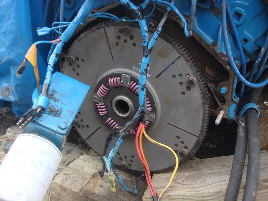

Mac,
I found a closeup picture of my old damper.. It has 8 springs and a steel wire insert. A bunch of holes in a triangular pattern on the outer radius. I tried to post a picture but...I just can't figure out how
Yes sir, that is the configuration of the new one that I have purchased. They might have discontinued the older version before 1992. Is your engine a 454, 350 hp?

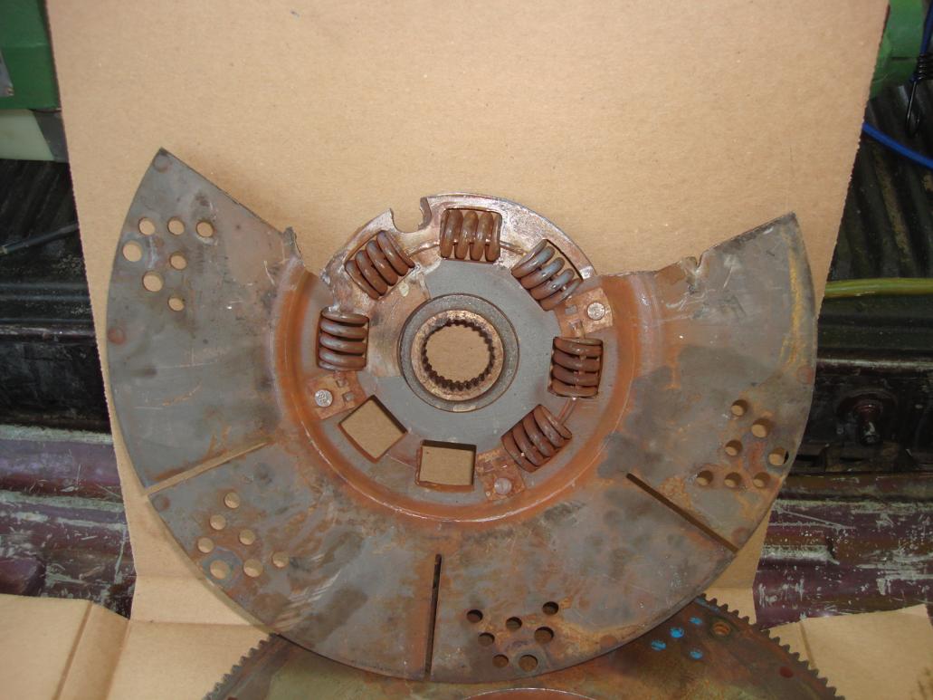

Yes...they are 1992 454...350HP By the way: Here is an attached picture of the old one....a bolt let loose and the centrifigal force caused it to fan out and jam against the bellhousing...SLICING the insides like a soft tomato while accelerating from 1000 to about 3000. Felt like I hit an underground telephone pole
