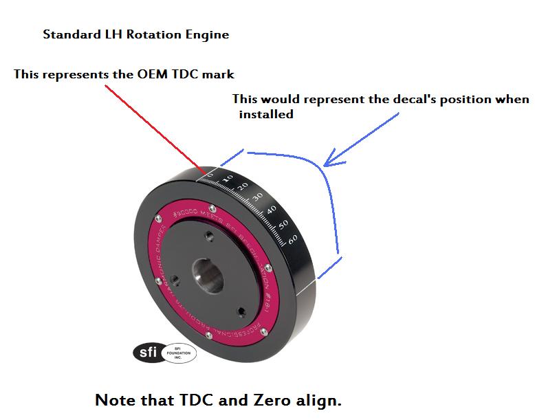

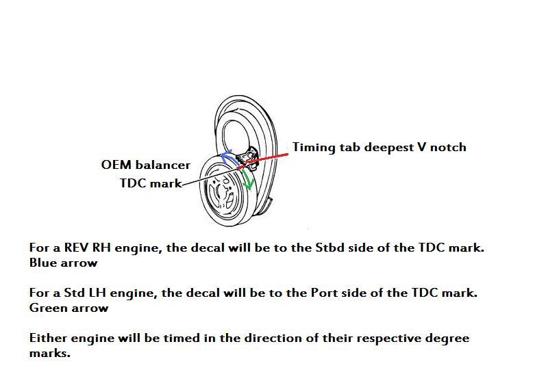

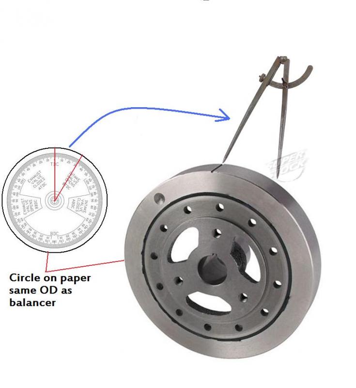

4 - As Mark suggested, if the balancer diameter is known, you can purchase and apply the correct decal.
For a conventional engine orientation the decal will install:
Port engine = zero from TDC mark towards Port.
Stbd engine = zero from TDC mark towards Stbd, and will be flipped around.

3. NOTE of Caution: The balancer diameter must be known at the time that you purchase the decal.
You must have a non-conventional installation... so I'll ditto Mark regarding LH or RH when looking at the flywheel.
Typically a Port engine will be STD LH Rotation...... Stbd engine will be REV RH Rotation.
That is correct..... line up the decal ZERO with the balancer TDC mark, but make darn sure that the following degrees are in favor of Engine Rotation, in that they "lead" the TDC notch in the direction of rotation.

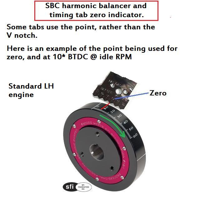

4. If 10* is your OEM BASE advance, then yes.

Great! I think I got it. One last question. I start off at 10 degrees BTDC at idle. I also understand that my total advance is the most important and it seems the numbers for that model engine is around 32 degress in advance - I'll stick with that number. So, if it's starting at 10 degrees at idle and i ramp up to say 3400-3600 RPM (as you state) will I see the advance number at 32 or 22? Meaing my ultimate number is 32 degress at 34k-36k RPM so am I seeing 22 on the tape and adding the initial 10 to get my 32 and locking it down there or am I looking for 32 degrees on the tape at that RMP. Just want to ensure I dont go over or under by the 10 degrees.
Junior, once you begin strobing your new timing marks this will begin to make more sense.
Remeber..... what you see as you strobe, will always include BASE advance and then what ever progressive is occuring.
BASE is what we start out with and set initially.
BASE Does NOT include any progressive advance until the centrifugal system begins.
Once out of BASE RPM range, as you increase RPM you can't help but see the progressive advance occur.
The timing light strobe flash will cause this to appear.
When you reach an RPM where the advance discontinues, that will be your limit RPM, or Full In RPM.

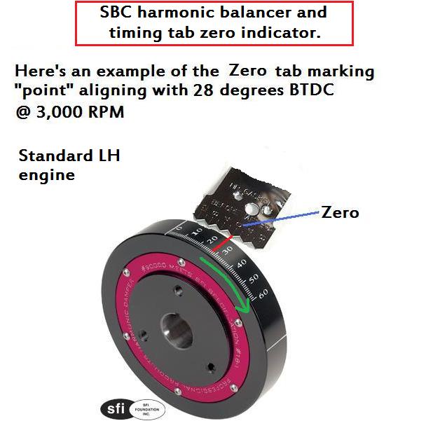

The more important numbers will be at/near 3,200 RPM or so.
Again, see your OEM specs so you do not risk engine damage.
I'll suggest as an estimate only, that you're going to see approximately 26* @ 3k rpm, 28* @ 3.2k rpm, 30* @ 3.4k rpm, and perhaps maybe 32* @ 3.6k rpm if we haven't already reached Full In.
If this is a good quench built engine, the numbes may be higher.

28* @ 3k rpm may be OK for a quench built SBC, but may be perhaps a bit much for a non-quench build.

Here are some answers
Are you suggesting that each harmonic balancer decal is installed in the same direction from the TDC mark???? IOW, when you strobe your timing marks, are you seeing the same advance direction at either engine???? Port engine the sticker is upside down, STBD sticker is right side up. meaning the numbers going by the flag go from 10 (retard) to 0 to 10, 20, 30 etc. as it advances by the flag. This is correct - correct? To be honest if the tape was orientated the other way I would not be able to hit any marks as I adjust the distrib BC it's too far away.
Do you have a Std LH Rotation engine and a REV RH Rotation engine..... or do you have a reversing transmission on the Stbd side???? Standard, from looking at the flywheel the STBD engine rotates righthad and the port engine rotates left hand
IOW, do you have two Standard LH Rotation engines?????
OK, so we do have a RH and LH engine then.
But I'm questioning why the Stbd engine decal would be the one that is upside down. Typically, Stbd engines are REV RH Rotation, meaning that this decal would provide additional degrees from the balancer TDC mark towards Stbd side.
Can you explain this for us/me?
See my ** comment below.

First.... I'm not sure that I'm following you re; this.
You should not need to look or see any further than at/near the deepest V notch in the timing chain cover "tab".
When we strobe these, the light captures the balancer marks, and the marks that we are concerned with will be right at the deepest V notch.
We will see them, but they aren't of any use when not at the deep V notch.
Perhaps think of the deepest V notch as a stationary TDC reference point, and the balancer TDC mark as a dynamic reference point that we can change by rotating the distributor housing!
Timing marks:
When the OEM balancer TDC mark is aligned with the timing chain cover deepest V notch, the #1 piston is a TDC.... and for our purposes, this will be TDC C/S (compression stroke).
Since you have now installed the decal, the full scale of the decal has now replaced the need for any of the additional degree markings on either side of the timing tab deepest V notch.
You could actually erase the smaller v notches, and it would make no difference for the way that you will now being strobing the markings.
As long as your timing light is in Standard Mode, just simply watch the degree marks that align with the deepest V notch.
Or..., when using a digitally advancing timing light, use the TDC balancer mark, and the deepest V notch.

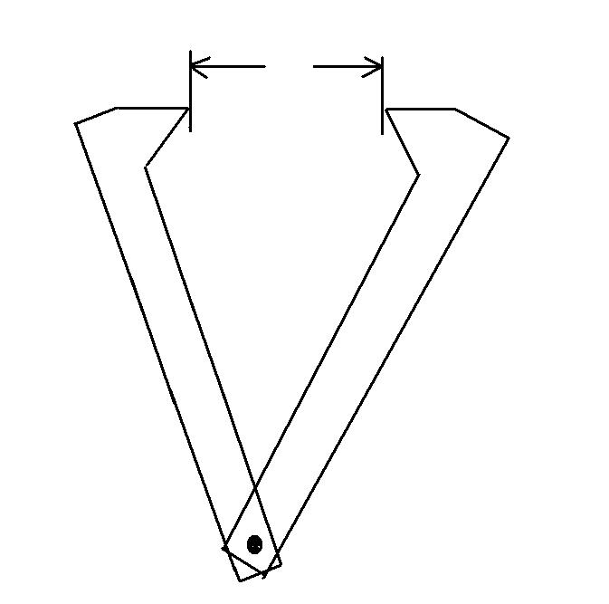

Junior, one more thought to confuse you further! :) (hopefully not!)
As we strobe these marks, the entire area (tab markings, and the entire decal markings) will be lit up by the flash.
All we're concerned with will be the decal markings that align and correspond with the deepest V notch.
Anything else that you see, has no bearing on the actual timing reading.
This is a horse race photo finish.
The finish line is stationary, and the flash captures where the horse's head is relative to the finish line.
We don't care about the horse behind..... we care about the horse that finishes.
If the horse is retarded, and doesn't finish in a fast enough time, we move the track forward.
If the horse is advanced, and finishes too quickly, we move the track backwards.
The track is moved by adjusting the distributor one way or the other.

In a perfect world, ALL Marine Engines would come from the factory will fully indexed balancers.
Std LH would be like this. REV RH would be oposite.

1..... meaning that the advancing numbers will line up port side of the TDC mark on my LH rotating engine.
2.....
And my STBD engine with a RH rotation will have this tape flopped - meaning the advancing numbers will line up on the (opposite) STBD side of the TDC mark.
Well, the horse race thingy was a long shot, but I though, what the heck!
1..... If you are talking about aligning the ZERO on the decal with the Balancer TDC mark, then yes, that would be correct!
2.....
Again, if you are talking about aligning the ZERO on the decal with the Balancer TDC mark, then yes!
See attached image

One more thought, and please forgive my rather crude drawings.
Not all timing tabs have a deep V notch for zero, instead, they will use a point.
Here is an example of one using a "point" for zero.

Kirk, is it possible that your degree decal is not correct for the balancer diameter?
We'll see the 5.7L using 6 3/4", 7" and 8" balancers.
As you can imagine, the circumference of each will vary, therefor the length between degree markings will also vary.
Much more so between the 7" and 8".
If a 7" decal was installed on a 6-3/4" diameter balancer, the degree spread (at the lessor diameter), will be too large. The end result would be that the degree increments will each be further away from the TDC mark........... of which means that a reading of 25 degrees, may actually be a true reading of 27 or so degrees.
(example only.... I've not done the math to know for sure)
Conversely, if a 6-3/4" decal was applied to a 7" balancer, the degree spread at the greater diameter, would be too close together.
Throw an 8" decall into the mix, and we have even greater concern either way.

As they are now, they are advancing via crankshaft angle to the tune of 18*.
Add your BASE of 10*, and there's your TA of 28*.
Add a BASE of 8*, and you'll have TA of 26*.
Add a BASE of 12*, and you'll have a TA of 30*
It's just math.
Are you suggesting once I'm at TA and 28* that I adjust from there, when I'm at 3k rpm?
No.... not necessarily....... unless you are unhappy with 28* @ 3k rpm.
If the TA number is correct for you engine build, then you would leave this alone.
Your BASE of 10* is should be just fine to start and idle on.

A degree is a degree is a degree.... doesn't matter at which radius we look at a degree, it's still a degree.
What does change, is the distance from one line of degree to another line of degree at a given circumference (i.e., the result of diameter).
This is why the decal must be correct for the diameter of the circle or balancer.
All it takes is for one mistake in packaging, or one mistake from behind the parts counter, and you may end up with the wrong decal for your balancer diameter.
There is a very simple way to check this, but you must know the balancer diameter.
Draw a circle on paper of the same balancer diameter.... let's say that it's 6-3/4".
On that 6-3/4" diameter circle, divide it into 30* or 40*.... doesn't really matter.... your decal will include 40* anyway.
Take a divider and set the points one at each angle line.
Lock the divider down so it won't move on you.
Now take the divider to your balancer, place one point in the TDC mark (which is also the Zero decal mark), and see where the other point lands on the decal.
If it lands at 30* or 40*, your decal markings are good.
If not...... the decal is wrong!

Kirk, it's tough to measure the balancer diameter while the front pulley is in our way.
I'd suggest making a make-shift tool, and use it to approximate the diameter. I say approximate, because there are only several diameters used for the SBC.
(see crude image below.... and don't laugh out loud! )
If you can make a wooden or plastic tool, similar to this below, set it for 6-3/4" tip to tip.
Lock it into position, and place it over the balancer OD.
See if it fits closely.
If not, open it up to 7", and test again.
If the balancer OD is 6-3/4", draw a 6-3/4" circle on paper. (see post #26)
Divide the circle into a 30* wedge, and mark it at the circumference (0* and 30*... or 0* and 40*).
Take a divider and set the divider to touch on zero and 30*, lock it down.
Now move the divider over to your harmonic balancer degree decal, and see if the divider dimension aligns with the zero to 30* on the decal.
Or use 40*...... 40* may be more accurate than 30*..... doesn't really matter as long as you're not doing only 5* or 10*.
(greater the reading/less chance of error)
Try this, and see what you get.
