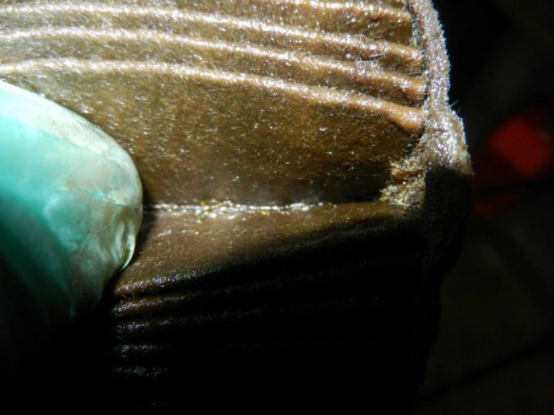

Here is an example of what can happen. This picture is of the oil filter media from a stroker MPI that was put together by a builder who installed the wrong flywheel. The slight unnoticeable vibration in the beginning became a bad vibration after 50hrs. The metal flake in the filter and oil was substantial.
Looks to me like a rebuild may be in order. Balance engine properly!!! These things undergo mind boggling forces!!!
