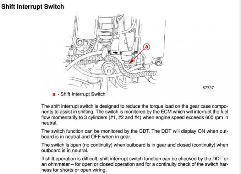

Your Optimax is a DFI. And I agree with mykc, it sounds like the shift event switch. You can disconnect the switch and see if you get full RPM's and no alarm. No need to go to the deal for this. Try this first.
thank you guys, but it is not the fuel filter/water trap nor the shift switch.
The filter was clean and no water in the trap and I disconnected the switch without any result.
Yes, mykc was right. I went to dealer, hooked it up to a CDS and there it was. It shows that the shift switch was faulty (jumping from neutral to gear). For now we bypassed it. Problem solved. Thanks again.
