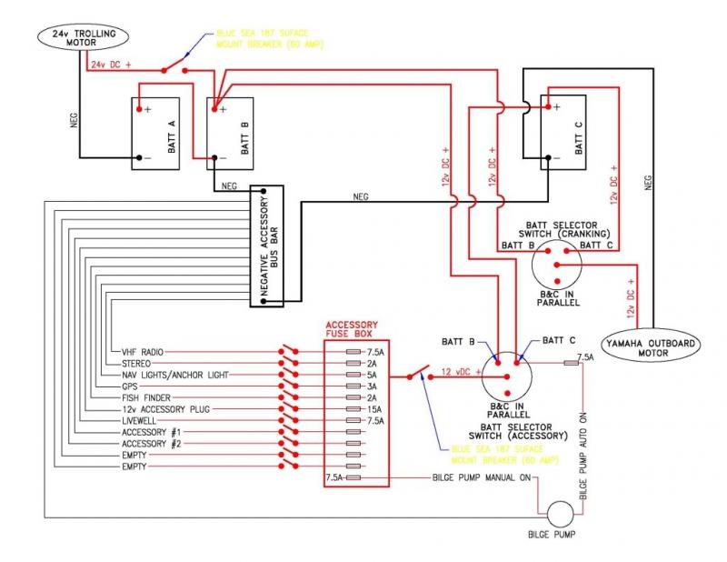

TO ANSWER MY OWN PREVIOUS QUESTION ON THE TAPPING OF 12 VOLTS OFF MY NEW 24 VOLT STSTEM, I HAVE TO RE-ROUTE MY ACCESSORIES TO MY SEPARATE 12 VOLT BATTERY.
I WILL HAVE 2-12 VOLT BATTERIES WIRED TO MAKE 24 VOLTS FOR MY NEW 24 VOLT TROLLING MOTOR
I CURRENTLY HAVE AN ON BOARD CHARGER WITH 2 - 12 VOLT LEADS.
HAVING THE ONE LEAD CHARGING THE EXISTING 12 VOLT BATTERY .... ADDING THAT SECOND BATTERY TO PRODUCE 24 VOLTS, WILL THE ONE CHARGING LEAD CHARGE BOTH BATTERIES WIRED IN SERIES.
IN OTHER WORDS, WILL THE CHARGE TRICKLE INTO THE SECOND BATTERY, ONCE THE FIRST BATTERY IS CHARGED ?
I KNOW THEY SELL AN ON BOARD CHARGER WITH 3 CHARGING LEADS ....
JUST TRYING TO SAVE A FEW DOLLARS ....
HOPE THIS MAKES SENSE
