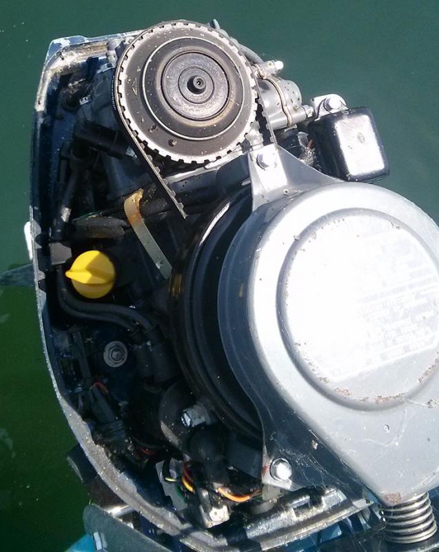

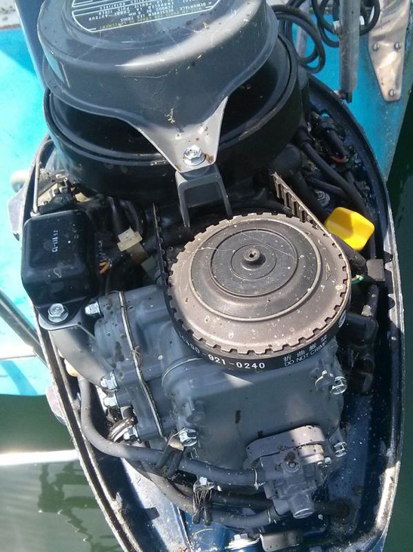

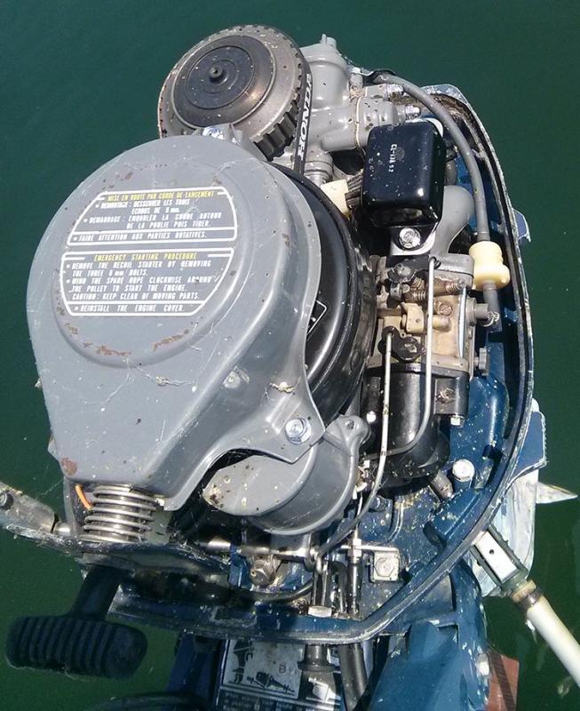

I've attached 3 photos in case that makes it easier for you to tell me which parts I should check/clean.

There are two "screw heads" on the upper side of the carb (seen on the right side of the outboard in your first photo).
The one towards the rear, or mounting end of the carb is the idle mixture screw. The other one, located more like in the center of the carb is the "slow jet". It is sort of a cap with an oring on the bottom.
What your guy probably does is take out the idle mix screw...then takes off the slow jet cap and checks for cobwebs. Then he probably sprays compressed air.... from one of those little computer cleaning cans you can buy at Office Depot...into the air passage that feeds that circuit at the front of the carb. NOT the big hole for the Venturi passage that the engine breathes through, but a smaller little passage off to the side of the big one.
That would clean it out with maybe an added shot of air through the passage from where the slow jet cap installs.
Reinstall the idle mixture screw and turn it in the EXACT same turns it took to take it out...install the cap.... 5 minutes and you're back in business!
