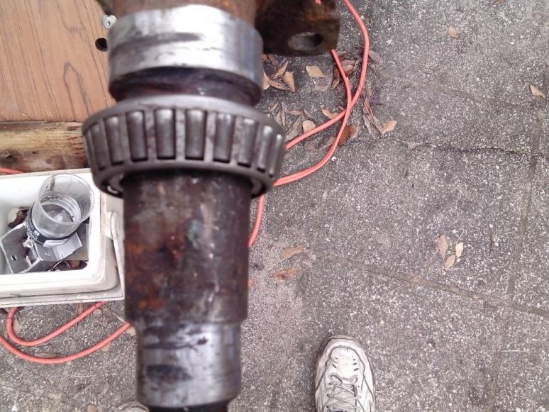

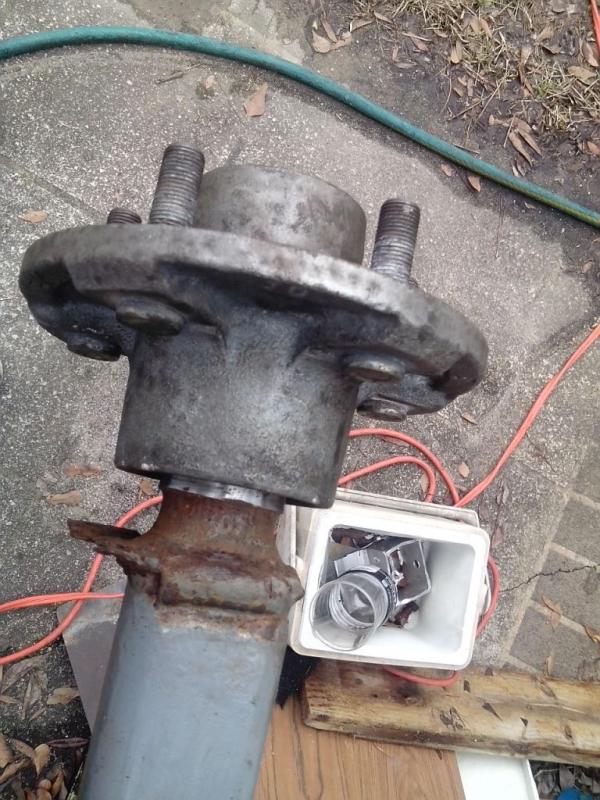

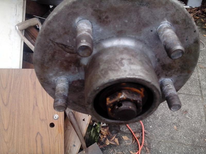

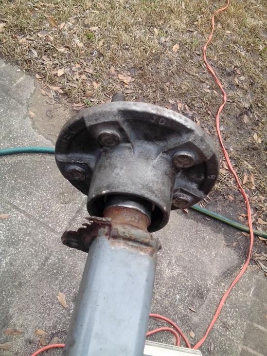

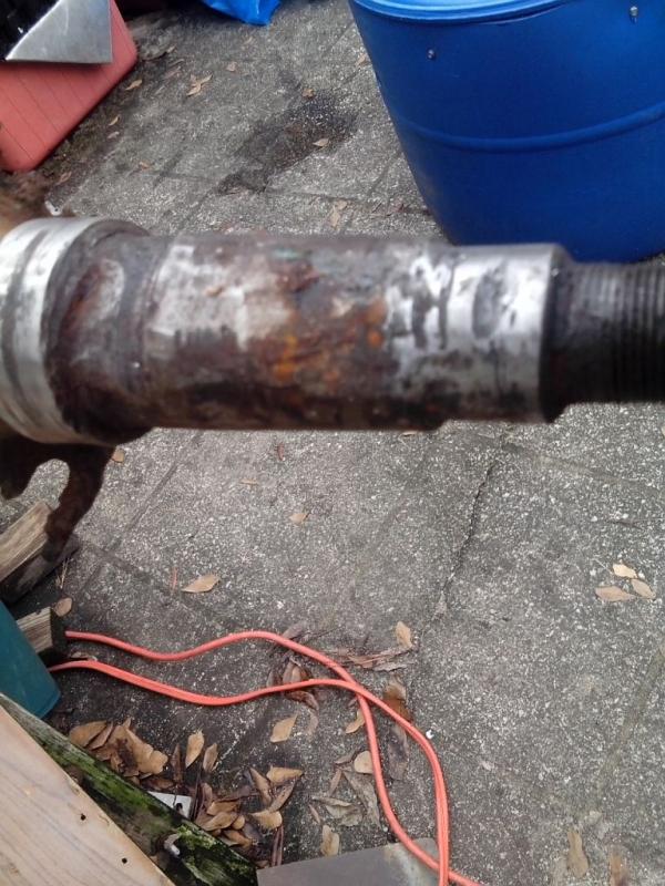

Recently spun a wheel bearing the broken pieces created a sizable grove in the center of the spindle I assume the bearing where grinded to dust.
The part of spindle where the inner bearing race sits on is also grooved bad enough
Where the inside race won’t slide all the way to it’s usalle position ( I had to grind w/ the angle grinder to get the bearing to side to almost the normal position this caused a flat spot) however I can still tighten nut enough to get a cotter pin in spindle.
also the inside part of bearing is stationary like aren’t both inside and outside races of inner or outer bearing should spin on spindle correct?
The assembled image the hub spins nicely even w/out any grease.

I have been sanding this stainless steel spindel w/ wet sandpaper 400grit however I didn't wet. wet sand paper cut in stripes not much grinding so I stepped up to called emory paper unsure of grit (but it's twice the grit of 400) not much results w/ however SS is very hard and I could be there sanding till doomsdays to get this spindel usable.

That is just garbage.-----Replace the axle with new.-----Cheaper than getting stranded / towing bill on the interstate.

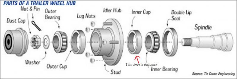

The inner bearing cup is it supposed to spin freely on spindle?
My spindle isn’t perfectly round and this bearing cup is stationary.

Theres a thing called a speedi sleeve that fits over worn seal races. They are relatively cheap. If it were me, I would see if there was one that fits your axle before going thru all the drama of replacing.
Yes speedi sleeves are great for saving old stuff. Used on a few occasions on some of my Land Rovers over the years. Comes with installation tool and you just whack it into place with a hammer. No special tools or training! Use a micrometer to measure across the seal race on the spindle. I'm sure it will be a very common size. That's the critical measurement for the speedi sleeve. You can order online, at a machine shop, or even NAPA.
The hub is the only thing that spins. The inner part of the bearing is stationary: it fits on to the spindle., and the outer part fits into the hub. The rollers of the bearing ride between the outer and inner portion of the bearing. The seal fits in the hub after you insert the roller (with LOTS of grease) into the hubrace. The seal keeps the grease inside the hub. mostly.
Once you get this back together, adjust the spindle nut until there is no more wiggle in the hub, then back off the nut a half turn. You need to leave the adjustment just a eensy bit loose so that when the hub heats up, the parts expand a bit and the adjustment is spot on.
OK I measure across the seal race on the spindle however there is a slite tamper?
can I attach
micrometer to race and rotate 365* for pure roundness mearsurement, remember I've been smoothing the top half w/ the emory cloth stripe like automoblie axles are smoothed.
sanding w/ emory cloth stripe dosn't show much material removed but I have removed some material to lessen the indention
thanksTB
