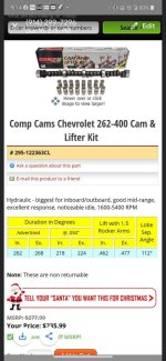

Here is a performance cam that has been reported to work well. Confirm it will work with your block and heads/comp ratio
