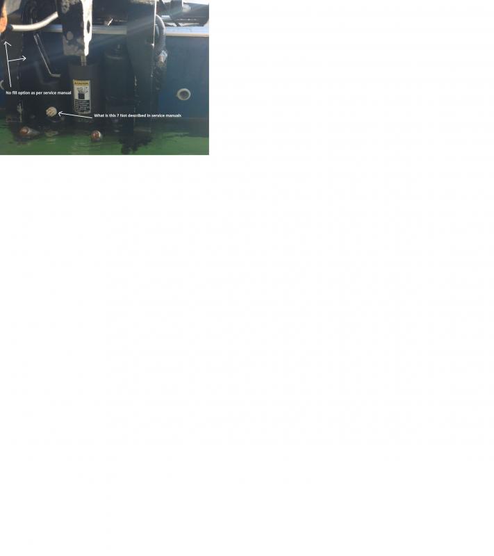

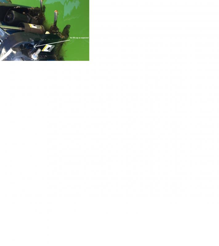

Hi, I have tried to find the fill cap as described in the service manual for a "System B" but it is nowhere to be found. This system appears to be a little diffrerent than a standard "System B"
In the spot where the fill cap is supposed to be, it is just a whole on the bracket and the cowl over the port side pump has nothing like any kind of fill cap.
It also has a plastic screw type of thing at the bottom of the port side pump and I have ni idea what it is for . Strange that it is plastic and I have not dared to to try and turn it yet.
Any ideas what this system is based on the picture I have attacted ? Could it be something newer that was replaced at some stage ?
cheers
Mark
Hi Chris, thanks for the info. I'll go and fill it up (Looks like a large screwdriver is to be used). I did find a reference to this yesterday in a manual I found for later models of this engine.
