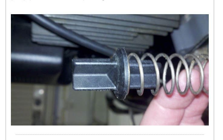

I pulled off the relief valve cover and found sediment build-up around the valve, the black plastic piece in picture, See attached pictures. I'm wondering if that is causing a flow issue to the thermostat and not allowing the thermostat to open all the way, since this is in the line prior to the thermostat. Tai

I clean this all out and tomorrow will clean out the similar valve on the other side of the thermostat. We will take it out next weekend to test - snow here today in Kansas. I will update if that fix the issue. I’m hoping that it the answer to why it happens at the same time. Will take the voltage meter in case it does go into limp mode still. Thanks again
Are you getting an alarm when the fault occurs? Could it be an overheat? I assume that is the water pressure relief valve you are cleaning and if it is that might explain your problem. Another test is to remove the thermostat and try it briefly with them out. Just been through something a little similar on a pair of BF175's. Unfortunately I never had to do anything to the BF90 we had for 10 years or so and can't remember much about it.
There is not an alarm and the overheat light on the throttle remote doesn’t turn red. With that said I am thinking that due to lack of water flow that the thermostat doesn’t open all the way and that causes it to think it is overheating or maybe it even is and so it goes to limp mode. Will be testing this weekend. Good idea about leaving it out just to test too. Will try that if it goes into limp mode again.

Yes this weekend we are taking out the boat again to see the poppet cleaning and flush worked. If not we will be looking at the lines and a carb clean. It is my understanding though that The motor will only go into limp mode due to overheating and low oil pressure so again hoping I found the issue. I will update the results
