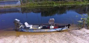

Tell us about the boat. Type, length, material, approximate height of the transom.
Is the motor the main or a kicker/troller?
Is the motor a short, long or xxl shaft?
Ok, that's it for now but don't leave town :)
type of boat is a gheenoe 13' fiberglass20" with jackplate cav plate is 3" below water it is the main motor longshaft and I do have a tinytach hooked up prop is a 9 1/2 x 8 5/8 model number is bf 9.9a 2003 by the serial number I know i stated it was a d in the post sorry about that w.o.t. is about 2900 @ 22m.p.h. good water pressure out of the peehole green llight is on oil is change as per schedule in book I do have all the record as I am the second owner.

Had the boat out this morning. put in @ 8am and trolled from the ramp had motor lowered into water battery charge was @ 12.9v @ 10:45 battery @12.4v tried to start motor out in the lake and wouldnt start check all switches and they ohmed out fine. Trolled bake to ramp and check again all switches good still wont start now battery dropping to 11.8 v when turning over just for the hell of it shift to f and back to n tried and fired up cant fined anywhere to check the micro switch could this be the issue. thanks
