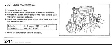

I have this from the manual. Does that mean

The real problem, which I hope looking at the compression readings tells you, is that the engine has lost about 50% of it's compression. And that's on the cylinder that still fires! More than half on the upper!
Loss of compression simply means that there is pressure leakage inside the combustion chamber. The leakage is caused by either the valves not seating correctly or the piston rings aren't sealing against the cylinder walls. Or both.
The valves not seating can be caused by bent valves, seat wear, weak return springs, carbon build-up or tight rocker arm adjustment.
The good news is that you can cure tight rockers by doing an adjustment. A valve adjustment. The procedure should be in your service manual. It requires some specific knowledge about how to position the valves and a little bit of finesse for getting them adjusted "just right" but it's not difficult at all.
I suggest your next diagnostic step to simply be checking the valve to rocker arm clearances. A too tight clearance will hold the valve away from it's seat and cause low compression.
You did good on the compression test. I may direct you to do a wet test but you should really inspect that valve train first.
