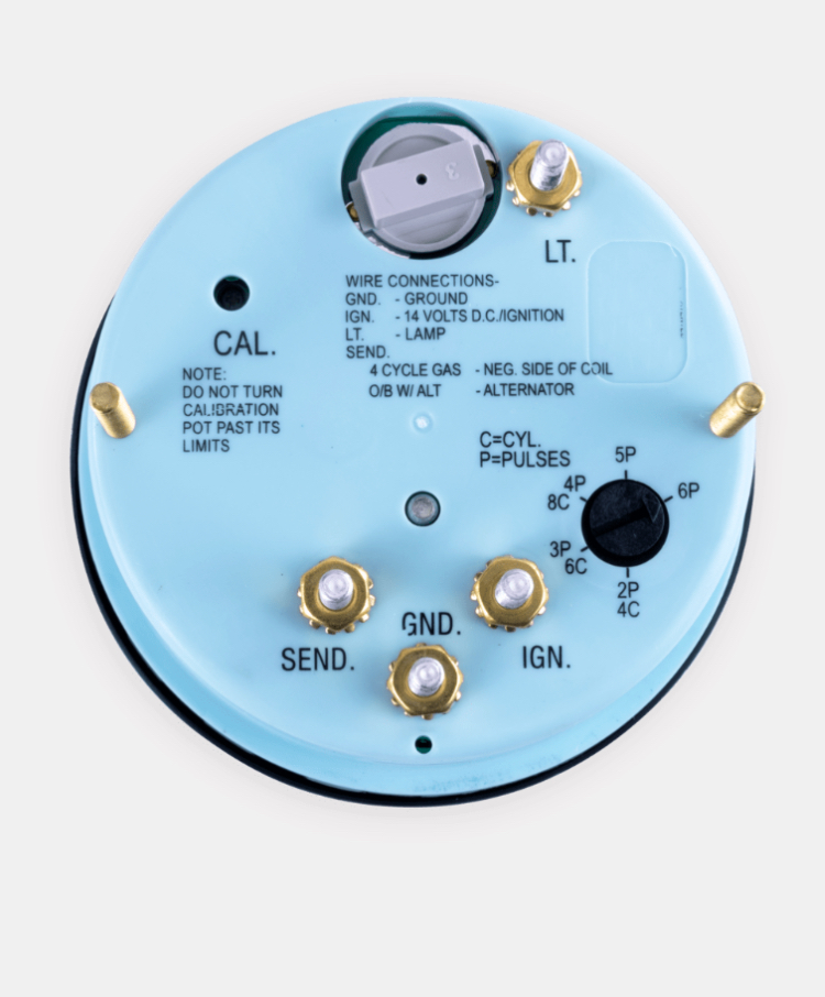

I'm fairly sure I have my tachometer hooked up correctly as i have it set as "3 pulse" and its showing an idling rpm of about 850 or so depending if its in the water or on muffs. Hopefully I've explained this to make it understandable as to what its doing.

I believe it’s a 6 pole motor, and I read that you half that number to convert to pulses on a tachometer. I tried the other settings and it was the closest one to stock idle rpm as well. If I’m wrong please let me know.

On the tach question, after researching I found a couple places where they said to divide the poles by half and that would be your pulse amount. I’m learning as I go tbh..thanks for any help.

A word on tachometer setting. The EFI get tacho signal from the ecm, not the alternator. The usual setting with a Honda tacho is 1. It sounds very much like it is over revving and you're chasing a problem that doesn't exist
hmmm interesting, I installed this tachometer
Sierra International 58255P Tach 7K​
I have it set to the 3p/6c as it seemed to have the closest normal idle speed. Is it possible this tachometer is not compatible with my engine? Have you ever heard of that happening? Here’s a pic of the back, there is no option for a 3cylinder engine so I just went with the pulse setting that I found online and like I said before I kind of went with the idle speed.

That will work but not accurate. The important rev range is wide open throttle so you can prop the boat correctly. To see if it is accurate at the top of the rev range, just trim out until it hits rev limit which should be around 6400rpm
I can get the boat cruising on top and, like you say I start to trim the motor out and at about 4200-4300 according to the current tachometer it starts clipping out and won’t accelerate anymore. I can reduce throttle and it will be fine until I increase trim or throttle, then it starts to do it again.
