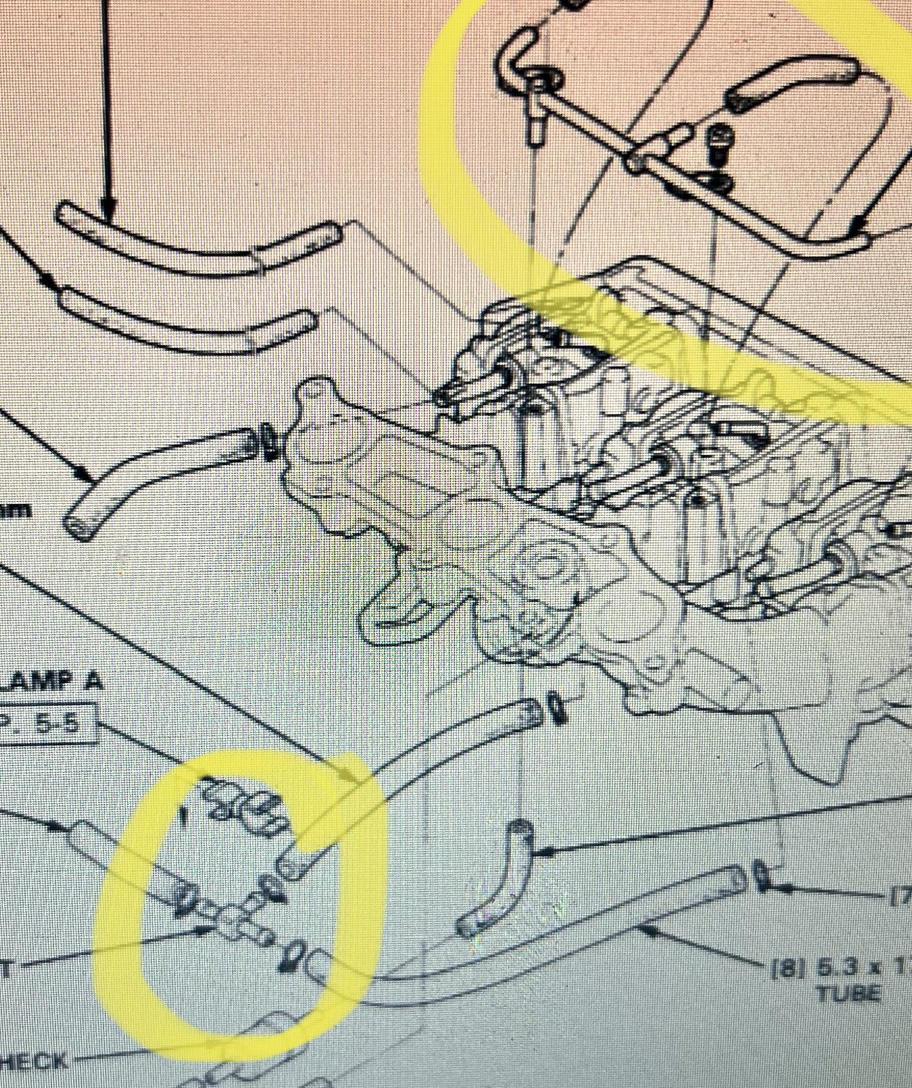

Here’s another thought…i mentioned when i pull the wire on the middle cylinder it doesn’t change the running much…just slightly. I thought maybe bc it’s the middle it is more balanced and less noticeable than the outer 2. Well also, when i turn the fuel screw all the way in on the middle it barely changes anything as well. The outer 2 carbs will almost make the motor die when the their fuel screws are turned in. Maybe the middle carb is having a partial blockage fuel issue and not making much power and as the engine warms it just becomes more apparent. Do you think the middle Fuel screw should change the motor rpm the same as the outer 2 when turned completely in?
Was thinking of my middle carb theory and saw these two areas that i didn’t reallly touch during the cleaning .
