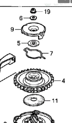

Just not sure why the plastic cog is so wobbly, took it off and doesnt appear to have any wear, all the surfaces look crisp and well defined. It's like there should be a weak hold down spring but exploded diagram shows exactly that i have there.

Nothing missing, took it all apart to check and exactly as is on the exploded diagram. Even the internal on the cog seems unworn, all the surfaces are good. Almost like there should be a hold down spring but according to the diagrams there isnt one
