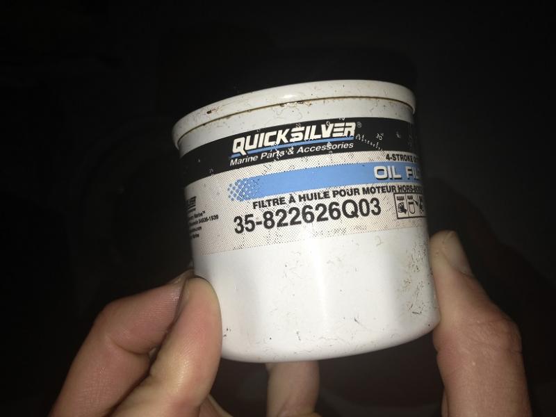

Ive had this oil filter (box picture) for a few months and just went to change it and was making sure its compatible with the old one (filter not in box picture). I am guessing someone told me months back that this filter would work but I figured I would ask first. Thanks

When I look up the part number 35-822626Q03 from the one I pulled from it before it shows its for a Mercury four stroke which I am sure is fine since I ran it for a while but still would like to be able to find the original filter part number so I can pick up a few. I have no problem spending the money since they are cheap I just dont know what one to get. Thanks and I appreciate the response
