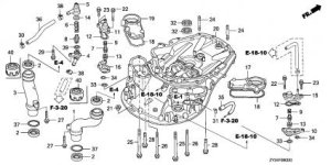

I had a Yamaha 225 Four stroke that did this and it is common. The problem is the cooling pressure relief valve is corroded and stuck open allowing the cooling water to bypass. During high RPMs the pump can overcome the loss of cooling water thru the relief, but at idle or low RPMs the pump volume is less and starving the motor from cooling water. On the Yamaha you can pull the relief valve and clean it or replace. It should be obvious when you pull it and see salt crystals and deposits.
Looking at the picture in the manual, it is under a cap that has two bolts and a small tube attached. it says to remove tube and two bolts, remove relief valve cover. looks like a five minute job. A lot easier than the Yamaha.
It is item 15 and associated parts on diagram attached
