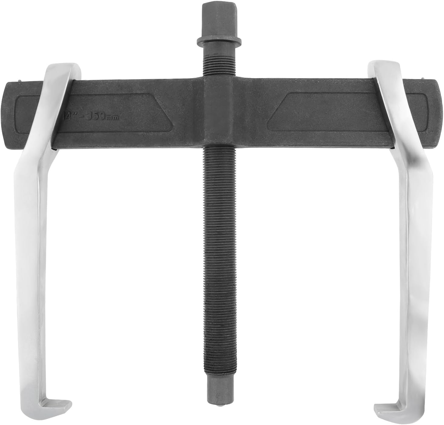

Trying to figure out if there is some way to put a puller on those tabs to get an even pull on them, but a jaw-puller tool like this won't work as the prop-shaft and the housing will move together.

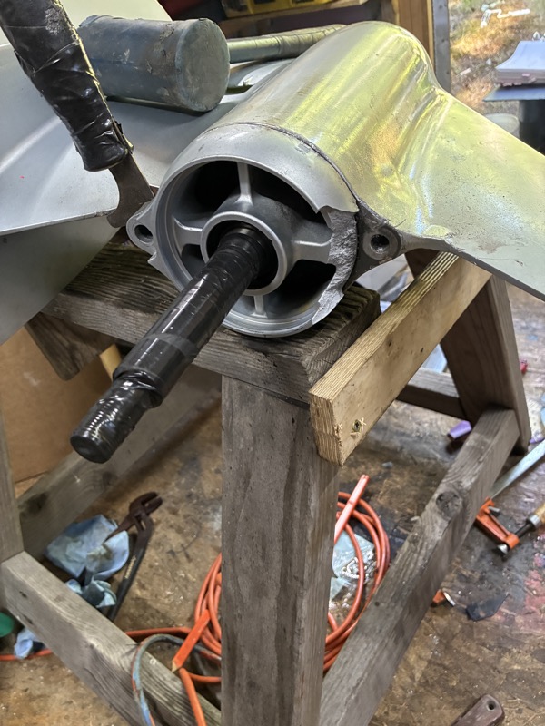

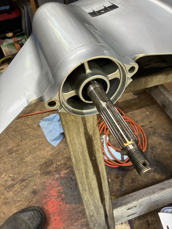

Well … it’s out. Not without sacrifice.
Nothing would move this thing. Ended up deciding to accept repaint and so started hitting it hard with propane torch to get case nice and hot. Even then nothing would move. Started air hammering on the tabs assuming I’m sacrificing my bearing carrier at this point but hopefully case save the case. Carrier not too $$ to replace but obviously rebuilding it will be a project.
Eventually it started to separate a fraction of a mm. Multiple overnight soaks and then could start getting a putty knife blade between tabs and slowing teasing it out with a massive amount of hammering and wedging.
Then my carrier ears sheared off - so that that point I’m committed and start air hammering on the exposed lip of the carrier. Even once I got that cleared it would not move at all. Took a lot more heating and air hammering to break the seal / corrosion at the deep oring. That the pen fluid never got anywhere near.
In hindsight now that I see how this goes together what probably would have worked is to flood the cavity behind the water pump with acetone/deisel blend. That goes down to the center of the bearing carrier and would have reached the stuck oring.
Oh well … live and learn. Hopefully someone learns from my error.

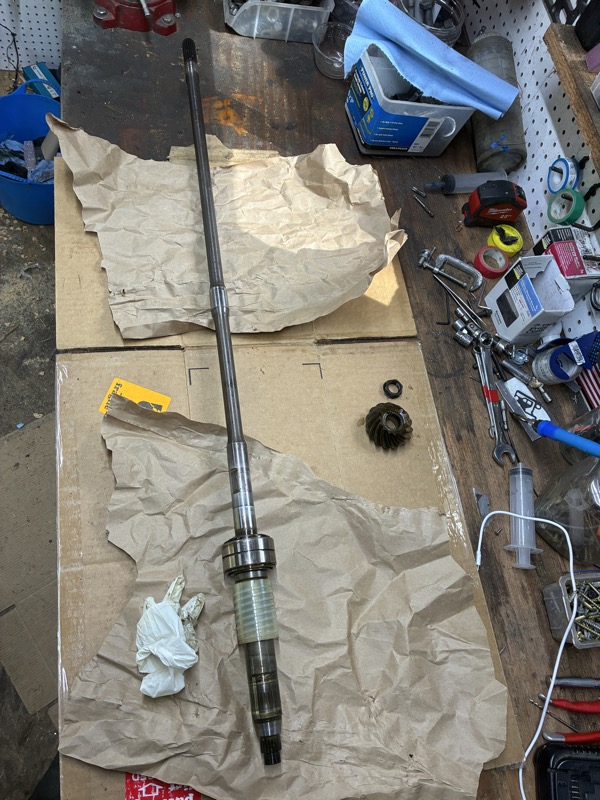

Drive shaft is out. Snapping that pinion nut free was also a bear. Could not move it with an impact. Had to build a jig to pin case to the floor, keep shaft straight and use a 36” breaker bar on the spline adapter.
