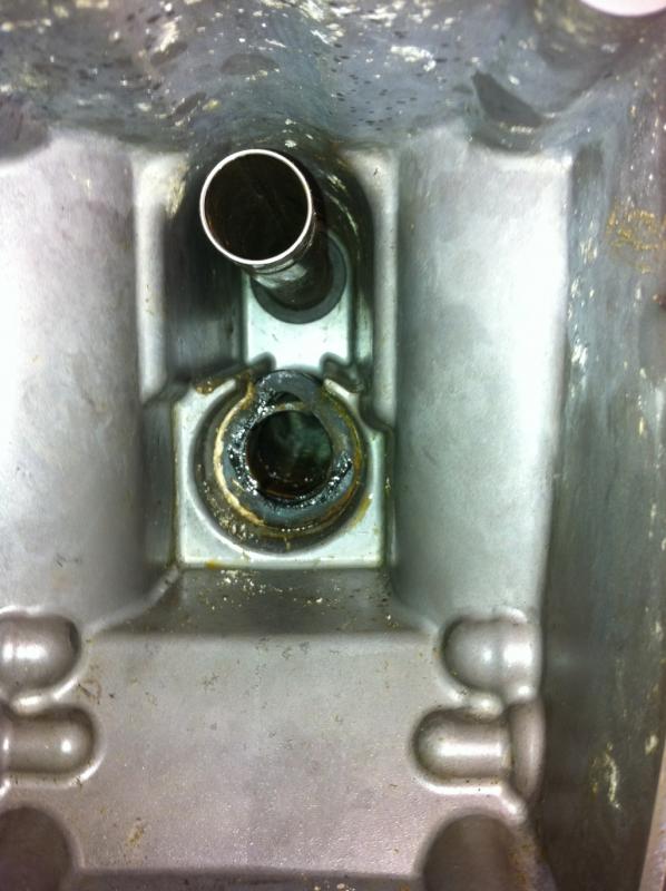

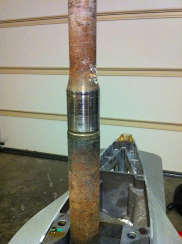

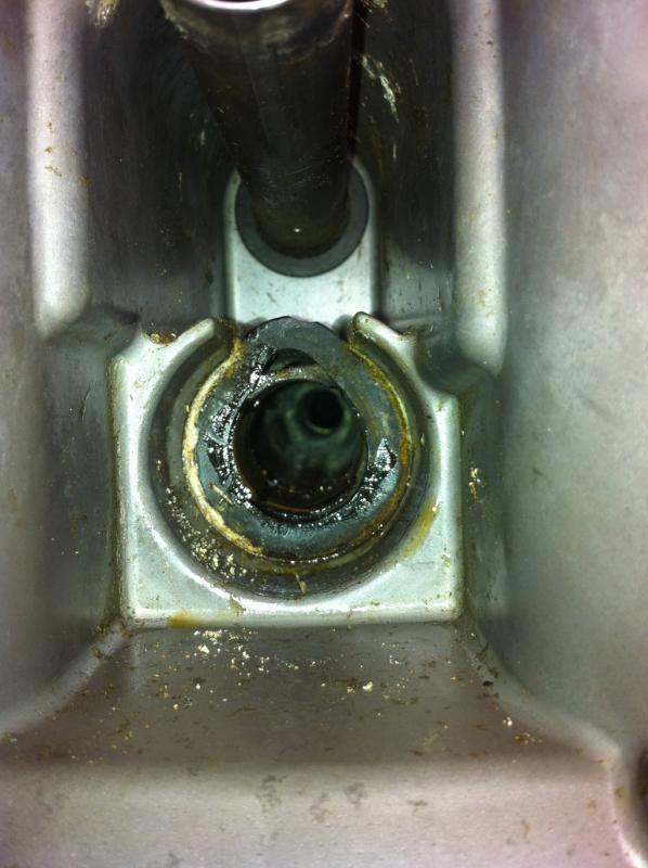

Here are some pictures of the bearing still in the midsection and of the driveshaft. Luckly my drivshaft isn't pitted and is in still good condition. I placed the new bushing over the driveshaft and there was not much play between the bushing and the shaft. From the pictures below the rubber around the bushing has crept through the "C" shaped housing. After seeing this,I decided to change it. I've been trying to spray the area with PB Blaster the last 2 days to try and loosen the buildup around the bushing. Going to try and tackle this today.

The extension case I used to replace the one damaged when the bearing failed has a 1/2" hole machined into the case just above the bearing housing. I replaced the water tube with the one sent with the extension case kit.
On my salvagable extension case, i had to use a dremel tool to clean out the groove that the c-clip snaps into as corrosion/salt deposit had filled it on one side pushing the c-clip off center as well.
To put the new bearing in I greased the outsides of the rubber and used a large diameter socket on an extension to push it tight into the housing.
Wow! Half inch hole! I assume the hole is located on the fwd. most area of the housing to aid in draining? What are your thoughts on modifying older cases, and do you think it will help? :confused:
Well my first attempt at replacing the bushing didn't go so well. Removing the bushing was very easy with the blind bearing puller that I was able to rent from Auto Zone. After I removed the old bushing, I quickly scraped out the housing where the bushing sits, then tried to insert the new bushing. Sprayed the area with Corrosion-x to act like a lubricant. Wouldn't go in easily so I ended up using a large socket on an extension and started tapping it in. After many taps I finally got it to seat, but the rubber surrounding the bushing started to disform like the original one where it would creep through the C-shape, but what was more serious is that the bushing had crept in the rubber surround thus disforming the rubber on the face where the washer and circ clip sit. After thinking about this and worrying that the bushing was not in-line with the drive shaft I decided that I had to try and take it out and try again. Unfortunately I could not get it out without destroying the bushing and no other dealers in my area had the bushing in stock so it had to be ordered and would be about a week. I guess that ended up being good, because it gave me time to thoroughly clean up the housing area. So I sprayed the housing area where the bushing sits with Corrosion-x and let it sit for a day. Afterwards I would use the side of a screwdriver to slowly scrap off the scaling and buildup in the housing area while trying to be careful not to scrape off the paint on the housing. Did this a total of three times. Everytime I would get less and less scaling. After the last cleaning/scraping operation, I used a dremel tool with a used wire brush attachment and cleaned out the housing before I put the new one in. After I got the new bushing, I started really worrying about getting it in and the problems I had the fist time. But I knew I had to do it, so I said a prayer and started. I coated the housing and the outside and inside of the bushing with marine grease this time. Got my large socket and hammer ready. Got the new bushing lined up with the housing and started to push it in. To my surprise, I could push it in very easily with a little force from my hand (didnt have to use the hammer) and eventually the new bushing was properly seated there the washer and circ clip could be installed.
In summary if you plan to replace the bushing on your BF225, use a blind bearing puller to remove the old one, thoroughly clean out the housing area of scaling, and use marine grease to insert the new one.

I know these are old posts, but I pulled mine out today. I have a 2002 225. The shaft has a little wear where the bushing goes. Once I get the new bearing if it’s too much I’m just going to sleeve it. The other alternative for those of you who don’t have a machine shop is to have it metal sprayed. A whole lot cheaper than a new shaft and it will be like new
