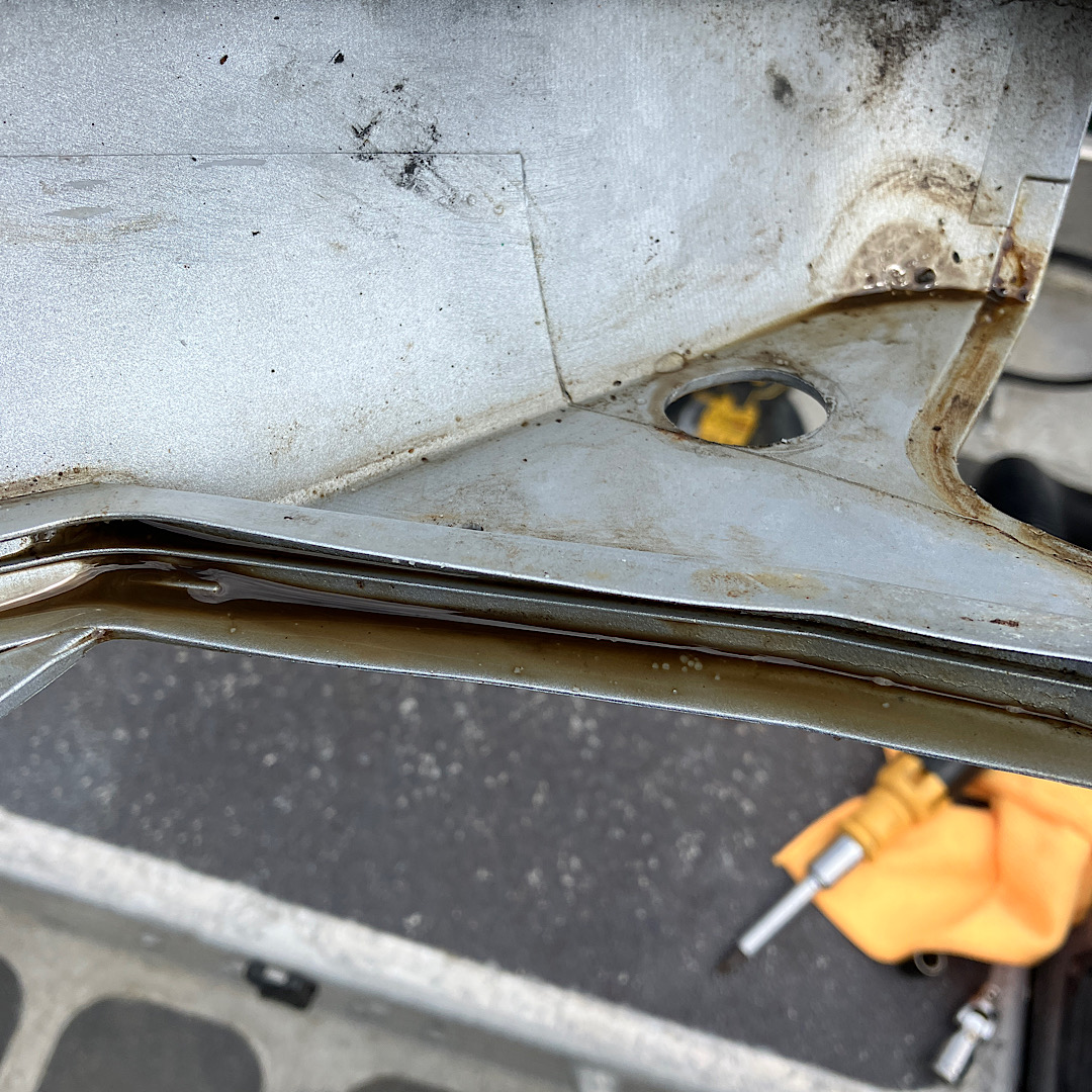

Last time I inspected a week ago - I cleaned everything up and when I opened up upper cowl found traces of oil here and there with most of it in the chase that attaches to the rubber strip.
Cleaned up all the areas and looked closer for suspicious leaks. Oil filter is fine - super clean under it and all around.
I noticed that the Right valve cover gasket has a little oil on it in both bottoms corners. Didn’t look like much of a leak but the left side was bone dry so it’s something. Also checked the coil tubes again and there was a small amount of oil in #3 tube (also RHS). Overall there was maybe a teaspoon or two of oil sitting in little nooks and crannies inside that I assume is where it ended up when tilted up.

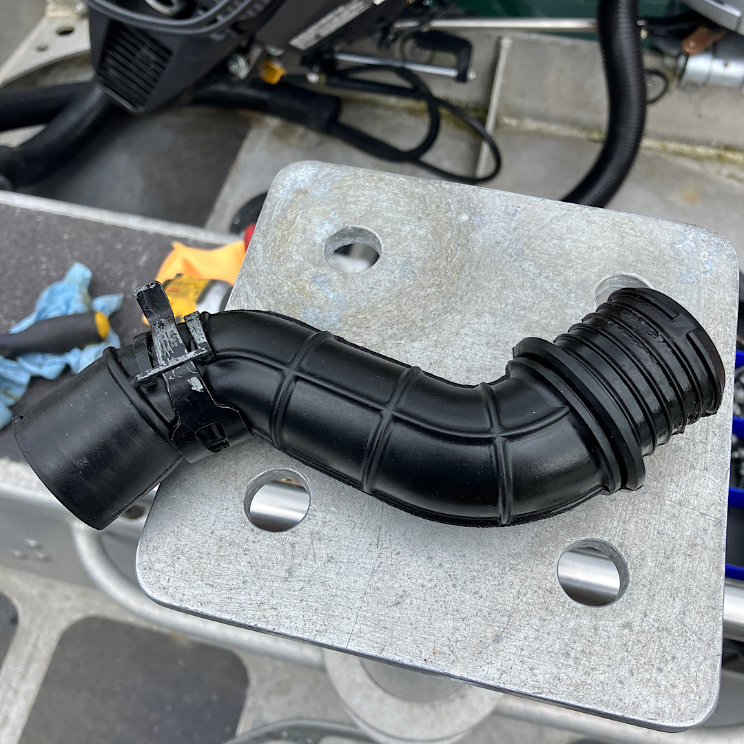

One area that looked more suspicious and had more pooling was the fat hose coming off the RHS valve cover - I always thought this was a cooling hose but the parts diagram has it listed as an oil hose? There was a little 5ml pool in that area and all in the hole it inserted to. It seems this would be consistent with maybe where the valve cover and possible plug leak could end up when dripping.

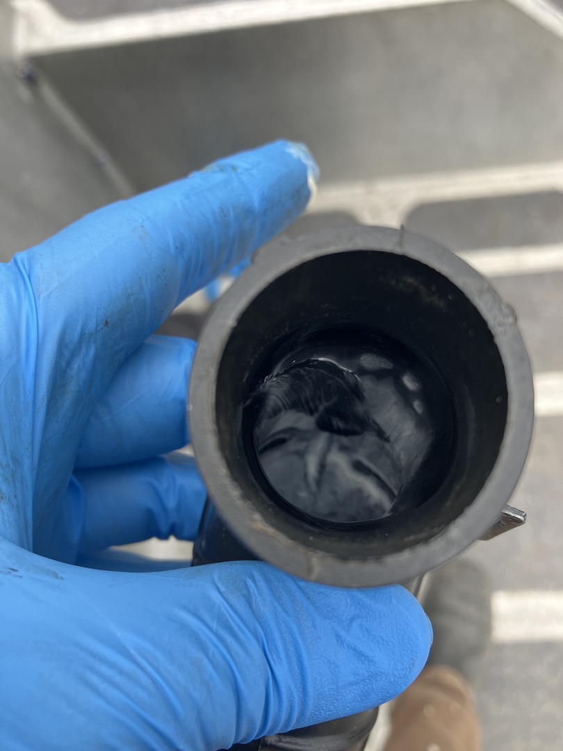

I pulled the hose off to clean it
and in addition to a lot of oil around the hole, the inside of the tube had a white gunk that looked like lithium grease or something.
Didn't look like what I would call milky oil - it was more viscous.

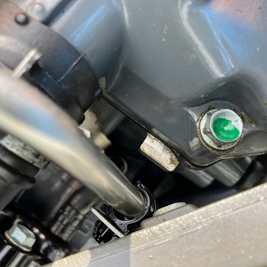

Got back to marina (14nm back) - and was sheening oil again. Gggrrr... quick look under the hood and #3 coil seal is most likely culprit - there was oil on the latch rail below it and oil inside the plug tube. It didn't seem enough to produce the sheen I saw - but it's the only thing that is wet.
I'm really confused why it doesn't leak on idle and why nothing leaks until I've been out for a very long time. Does it just take the oil getting to a certain temperature to be thin enough to leak out? Maybe it takes that long to work its way down around the cowl and eventually out the back. When I shut down the engine - the sheen clears out fairly quick - which makes me feel like I should be able to see a drop coming off the #3 coil area when it's running.

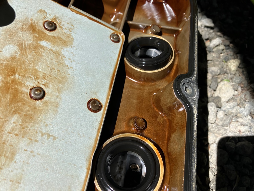

Pretty convinced my engine oil leak is combination of #3 plug seal (majority) and RHS cover gasket. The plug tube dropped 1/4 tsp or so of oil during my test run onto the rags, and there was a smaller few drops collected below the gasket. I hadn't inspected the plugs themselves, so went to remove #3 and realized that the coil tip was stuck on the plug still. After a lot of fussing managed to get it off - and i'm fairly convinced that the plug wasn't torqued fully. I found a lot of oil on the plug threads as it came out. Cleaned and re-torqued to spec (18NM) and mopped up all the oil in the crack between the metal and the seal. Took it for another long run - and this time nothing leaked out on the sorbent rags but the seal was oily again and some smaller amounts of oil in the tube.
<aside>
Had an interesting chat with local boat.us guy who has same boat and same 225's. He said that he blew a coil once and it was a hot mess - melted and fused itself into the tube and very challenging drill out. Said that if not seated properly they can arc. Also mentioned that he now carries a laser thermometer and periodically pulls his cover off and lasers the top of the coils (without removing) to ensure they aren't getting excessively hotter than they should - which is an indication of pending failure.
</aside>
Parts ordered and onto the trailer she goes...
This is my #3 seal. Can’t tell if it was kicked out like that due to me pulling cover off or that’s the way it was when leaking. Either way I’d says it’s a smoking gun at this point.
I dont think there is any way that seal pulled out like that from taking the cover off. They are in there tight. I've replaced some and had to completely destroy the old ones to get them out.
