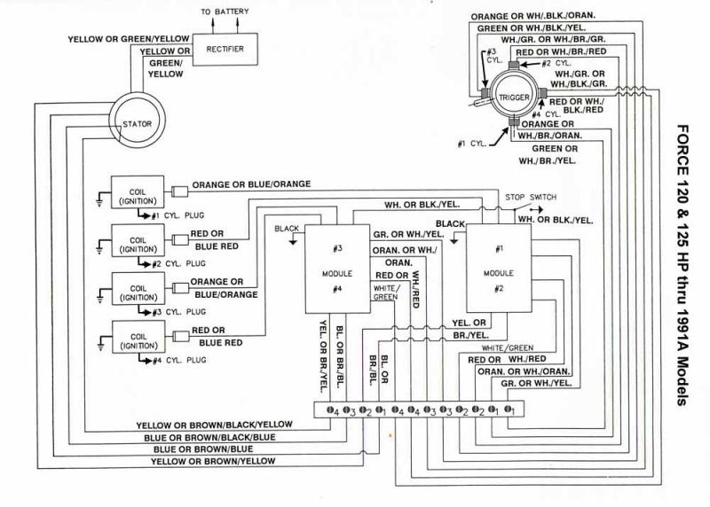

I am an new boat owner I just got a bayliner the boat was winterized the previous owner said and hasn't been started in a while the seats were damaged so bad that I could see the foam but wanting a boat I got it now after working on the boat cleaning out the motor and buying the right stuff to start it I try to start it and I don't get any pop. it will crank but I don't think I'm getting spark I have champion spark plugs that I will be getting and I will post my compression. I first thought my problem was coming from the kill switch after looking under the dash and seeing it un hooked I found 2 black wired and followed them both back to the ignition on the same point. I'm not sure what wires from the ignition go to the igniotion if anyone could help I would appreciate your time
Wires are black with yellow tracer stripe......
