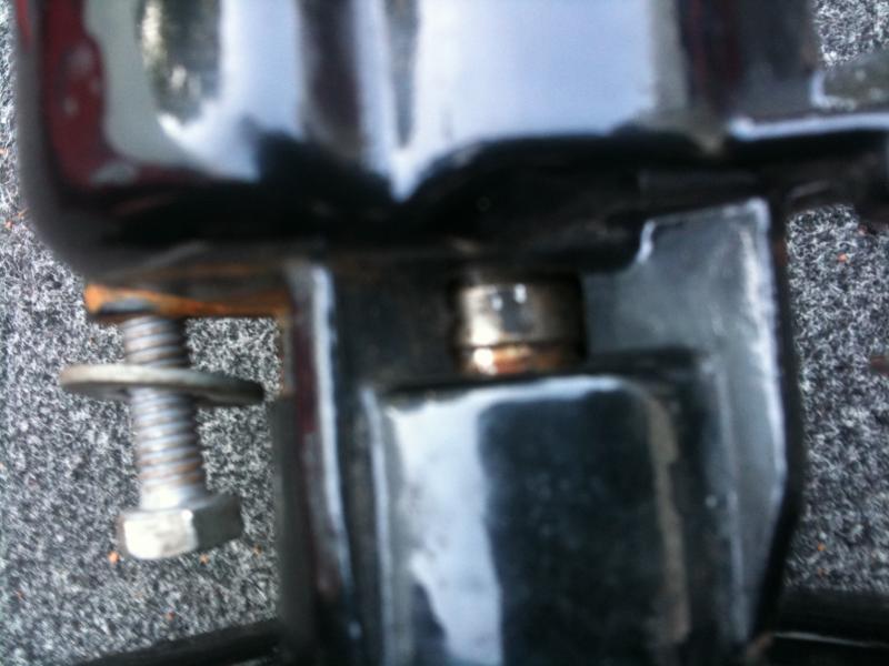

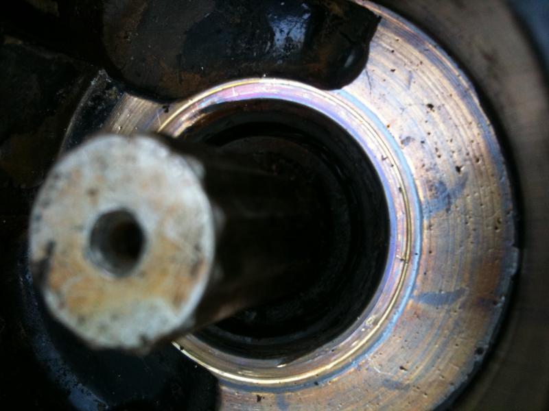

I don't remember my water pump leaking. However, recently it has started leaking. It appears to be coming from the front of the pump (pic 2)not the the back where the two halves come together. There is some sort of rubber seal (pic 1)on the front of the pump that I think may be the cause of the leak.

Looking at the parts schematic, I don't see a shaft seal kit. This doesn't mean that it can't be serviced, but apparently Volvo feels it is less bother to just replace the pump totally. If you are inclined to press out the shaft and seal, you may be able to cross reference it and get the bearings as well.
If parts are available, then yes...... it should be repairable.
Volvo shows two pumps for the 5.7 GI-PMDA
Front crank mount..... and a V belt driven pump.
Here is the front crank mout pump. Note the Water pump kit 3854287
There may be a shaft seal within the base unit, but it appears to not be shown in this schematic.
With any impeller type sea water pump, the two impeller thrust surfaces are equally as important as the cam and impeller.
Your wear plate (thrust surface) needs to be replaced. It is severely pitted.
Since it shows this much wear or pitting, the oposite thrust surface is likely in need of replacement also.... but this integral with pump body/housing # 10.
