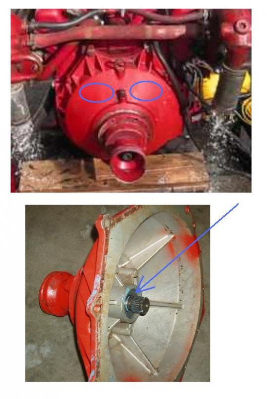

Actually... there is a way.
Bore a small round "peep hole" into the flywheel cover..... possibly in the areas where I drew in the blue circles.
A nice round small hole will not sacrifice any integrity.
Hmm. Not a bad idea!. Im not sure i can get in there to drill a hole or one big enough to see into.
There is a inspection plug drivers side that i removed and all you can see is the flywheel and ring gear. It was totally dry with no evidence of grease or oil on it though which i assume is a good sign.
Pat, I have not done any testing for this scenario. But I'm thinking that if the FWD seal has been pushed out of it's bore, it's doubtful that the grease would reach the drive coupler or flywheel. The seal will be hanging on the PDS blocking it somewhat.
The PDS is also a rather small diameter, so the volosity may not be enough to sling the grease out with much force.
I think that it's more likely to just droop and fall.
But then again, I've never had the need to test or investigate this! :D

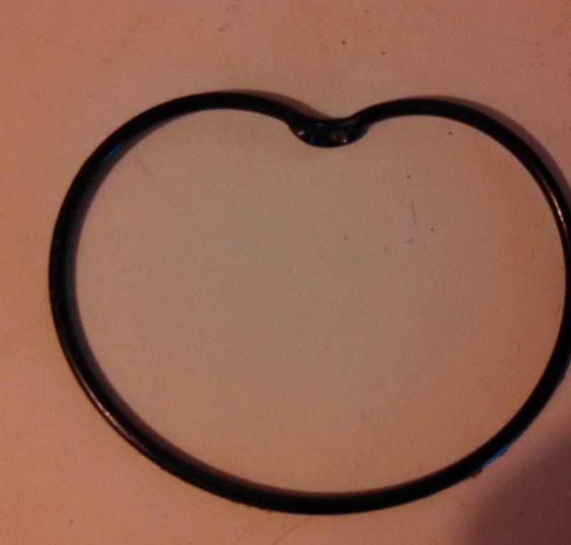

So. Went to 2 boat shops and Napa and none had the O Ring. Took a long shot and went to the "Co Op" farm and garden store and sure enough they have a 5 by 6 foot section of O Rings so i bought 2 of the right size.
Put it in did a simple pressure test and no leaks:cool:

Be careful substituting farm/general O-rings for OEM. Some of the OEMs cannot be cross referenced.
We'll see some differences in material, density, thickness, etc.
I lowered it to 10kpi and just checked it. It is still at 10kpa and ill leave it till around noon today. Been close to 12h so far.
I suppose your right and i just need to make a fitting for a pressure test. Just hate spending the money for it.
The O Rings are for rebuilding pumps mostly. I did buy 2 so ill take the extra one and put it in some 30wt oil just to make sure it does not expand.
I did make sure it felt like the same stuff and it is so close to the same diameter i could not tell any difference.

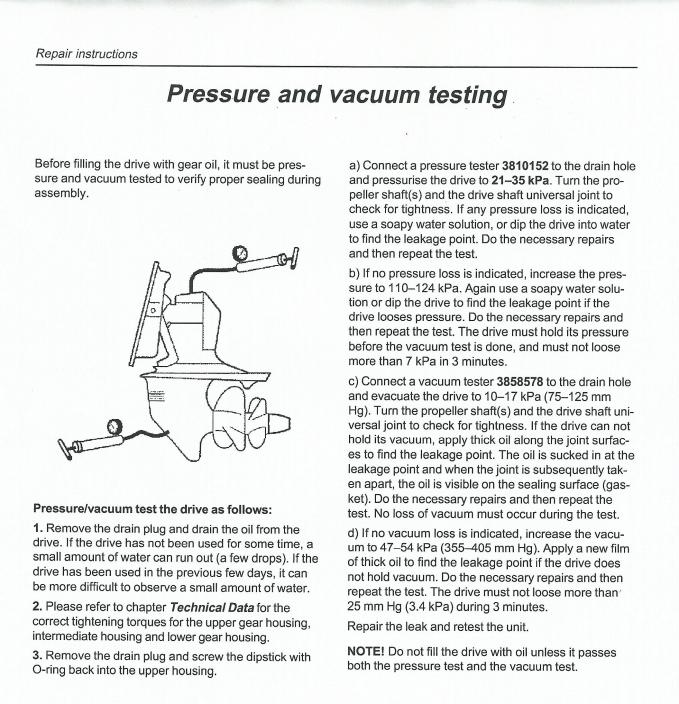

I have a fitting made up with a pressure gauge attached so now i can do a proper p/v test.
The test procedure ill use is on page 126 of the manual i have. Its does not list time for total test.
It does not say how long to leave it or how much p/v to use after the initial high pressure and vacuum test.

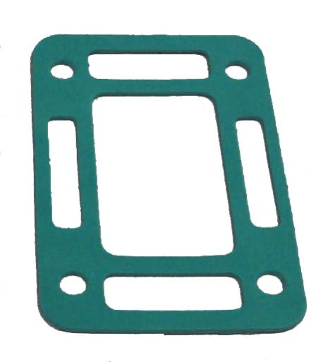

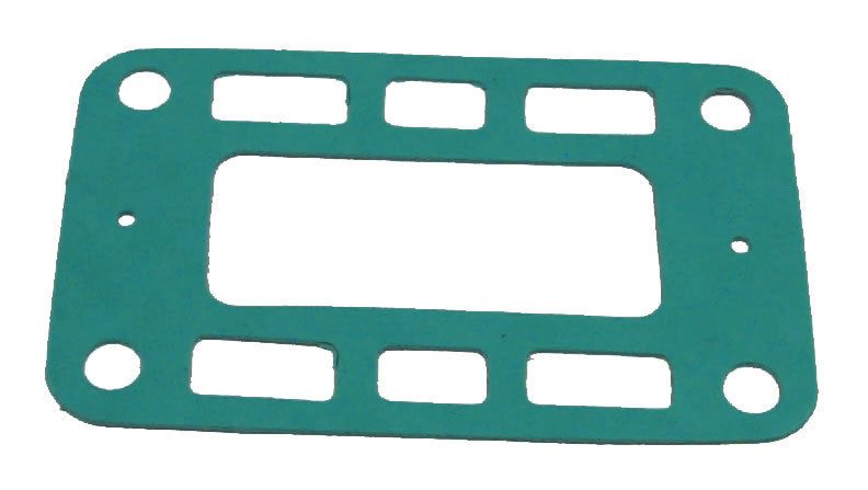

I read some place(i though in this thread) that when replacing the exhaust elbow gaskets you want to use the fully open ones.
Well i ordered the ones like the ones that came off when i took them off with little holes on the ends not fully open style. I can change that though if the fully open ones are the proper gaskets to use by just cutting out the ends?
Also Ricardo you mentioned to order the flexible exhaust hose 2 inches longer then what i have. Mine measure 6in so i need 2, 8in sections?

I read some place (i though in this thread) that when replacing the exhaust elbow gaskets you want to use the fully open ones.
The AQ series exhaust system does not accommodate a Full Closed Cooling system.
(manifold supply ports are too small, elbows are not ported, and the down angle of the elbow does not allow for a ported riser/spacer)
If you are either seawater or closed system cooled, the exhaust Elbow transfer ports must be fully open.
See above.

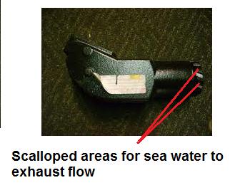

These use 95mm soft wall Marine exhaust hose, of which is not actually flexible in terms of making angle turns.
This 95mm soft wall hose can be somewhat difficult to source.
The OEM are almost always too short. Why.... I don't know!
You'll need enough length so that the two elbow band clamps do not squeeze down over the scalloped areas of the elbow, and yet enough length to slip onto the Y-pipe with enough material for those two band clamps to tighten down on the pipe.

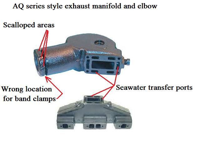

Reason: if the one of the two elbow clamps tighten down over the elbow's scalloped area, the hose will eventually become depressed into the scallops.
This will restrict outgoing spent seawater and may cause over-heating.
Here are the elbow mixing chamber "scalloped" areas that I am talking about.
Also, two OEM 95mm exhaust couplers (the ones that are too short).
Keep in mind that two worm drive band clamps are required at each end of the exhaust couplers...... or a single SS T-bolt clamp can be substitued at each end if that helps.

Here's a better image of the spent seawater transfer ports, and the scalloped areas.

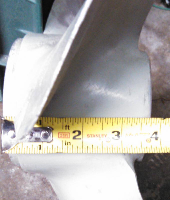

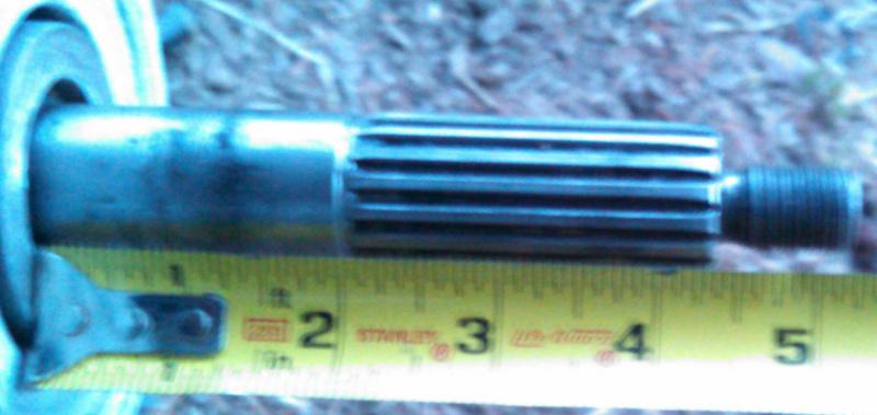

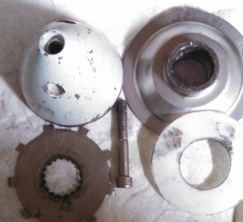

So i need a new prop and i think what i have works but is not the right setup
I Think i have a long shaft with a short hub?
I have looked at some pics but they all show to measure from a shoulder to the end of the splines or end of the threads
So im a little confused:confused:
Sorry there not clearer. Can't find the good camera!
Also any help with above post #107?
Pat, the 280 prop shaft is longer than the 250, 270, 275....... but all net the exact same exposed spline length when the correct spacer/line cutter is used.
Your 280 prop shaft requires the long spacer/line cutter regardless of prop hub length.
I realize that the manual lacks giving us some information.
10 to 12 psi is good for the pressure leak-down test.
Pressure may become reduced, but it should flatten out and hold 7-8 or so psi for hours.
The longer it holds the better.
Oil must be drained for this test!
Vacuum (negative pressure) is measured via In.Hg. (inches of mercury being drawn up a vertical column).
Draw as much negative pressure as you can… you will not harm the seals.
By nature of design, the seal with the least holding resistance will cause the vacuum reading to flatten out.
A good holding reading will be in the range of 6 to 8 InHg.
Again, the longer it holds the better.
The oil need not be drained for this test!

If it was yours and your ordering a new prop what would you get? Short or long
Thanks for the p/v information. Ill be sure to let you know the results of the test!
Re: POST #107... It took a bit of doing ( annoying permission restrictions) but the attached page from the
OEM shop manual shoud help. Zoom in (CTRL +) to read.
HI. Yes that is the test but if you notice it has no mention of a time or pressure over 3 minutes. That might be all the factory recommends though i don't know so that is why im fallowing Ricardos suggestion.

So i will be fallowing his advise to get this project all bagged up and on the water!
Yes, the longer the better is true, but.... the intent of the limits in the OEM manual are to establish a go/no-go for the drive. Lets say for example you test the drive and all is OK @ 3 mins, but at 1 hour ( or 20 mins?) it has dropped more than the specified limit. What are you going to do? Look for the leak? Tear down the drive? At that slow a leak rate finding the leak may be challanging.
