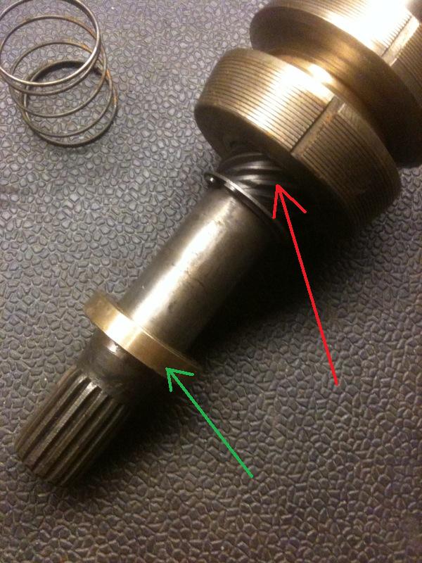

Here is a vertical shaft, sliding sleeve and brass split ring keeper (green arrow).
The OD sides of the brass splint ring keeper should be perfectly parallel to one another.
If not, it is expanding.

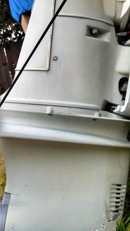

Once out of the water and looking things over i seen oil coming out of the side of the lower unit not much just a drip or two where it hooks to the mid section just above where that cap screw is on the side.
I just put the brass keeper on a piece of glass, non-split ring side, and if it rocks, time for a new one. I have seen, in desperation, guy's put the brass collar in a press and push it back the other way. I've always got old parts and pieces laying around so I've have never tried this way, don't think I would.
As the keeper expands, the upper area protrudes some. That may be what you are seeing.
However, what's important are the sides, as they must be parallel to one another.
Easiest method for testing, is to place the OD of the keeper between the jaws of a dial indicator caliper.
If you see no daylight at any contact point, the keeper sides are parallel, and it should be OK.
If you can see daylinght at any contact point, the keeper is expanding from the force of the carbon steel split ring.
Need more info! Pictures if possible.

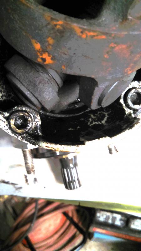

Here is a pic showing where the oil is leaking between the mid section and lower unit located between the 2 cap screws shown.
No i did not change the bellows. i unclamped it from the out-drive and looked in it. It is clean and dry.

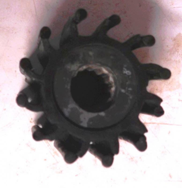

New raw water impeller. It is cracked, collapsed and missing a couple vanes.

The oil leaking at the shift mechanism cover is likely from the eccentric piston seal.

You'll want to find and retrieve the missing seawater pump impeller blades.
If not retrieved, they can cause problems.
Post a photo of the seawater pump. If large volume, there are some inherent issues regarding the correct impeller.

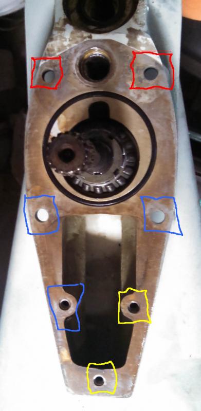

Ok so got the Transmission off and the lower unit off and this is what i found.
YIKES!!!!!!!!!!!!!!!!!!!!!!!!!!!!!!!! #^$&*^#(@*!)*@#&)$*(@#
The lower unit could have been severely damaged or even lost in the lake!!
Check out the picture of it from the top.
RED indicates no bolts there at all!!
BLUE indicates lose bolts
Yellow indicates tight bolts.
I never even thought to check if they were there and tight after i bought it.
It is leaking from the shifter seal.

The impeller if the big Jabsco one. I think its 1.990 but could be wrong

Pat, Nothing but normal everyday Volvo things going on in your drive and I say that in a good way as Rick and I see them everyday. The upside down, as I call them, bolts falling out is nothing new. The shift shaft seal leaking is an everyday occurance when they get old. The two o-rings between the inter and lower never leak unless the bolts become loose and fall out. Impeller is a typical too old to be in use impeller. Bearing crosses should be checked yearly and if one is tight, they've not been checked. Grab your good manual and you shouldn't have a problem doing what needs to be done, we're here for you.
If you have doubts about your ability on your drive, Rick or I can do it for you for reasonable. Rick did mention he might be giving up working on them though. We're both the next state over so a shipping time frame wouldn't be bad.

Note regarding the main drive gear seal:
The four clamping collar cap screws need to be removed in order to
remove the bearing box for this seal replacement.
DO NOT attempt to remove these without first applying heat to the four corresponding thread inserts!
If the socket heads become rounded out, you'll be taking your transmission to a machine shop for some delicate milling machine work!

If you have the large volume Jabsco seawater pump (6 cover screws), measure the pump body impeller cavity depth and confirm with the new impeller.
The .090" difference in depth between the Jabsco and Johnson impellers is critical.

Here's an image of an early AQ series transmission (pre-A drive) recieving milling machine work to remove the four rounded-out cap screw socket heads.
Each cap screw seats against a very delicate shoulder.
These shoulders are necessary to prevent water intrusion, and is why we can't simply drill these socket heads out without risk to these shoulders.
Heat is your initial Friend here....... and your ONLY intial Friend!
If you hurt this friend's feelings, your next friend will be the machinist! :eek:

I'll admit to being one of the people that made that mistake. After rounding out the cap screws, I took the gearbox to an automotive machine shop. They proceeded to drill out the bolts, and also removed the bolt shoulder seating surfaces. And, of course, the sealing ring was ruined. Bad part was, I wasn't really aware of what had happened, just had a feeling that it didn't look right.
Luckily, I was able to buy a freshly overhauled and sealed gearbox from Rick. Be aware that they're not cheap.

Im pretty sure this is the impeller i need. Jabsco 18777-0001-P It does have less fins? 10 instead of 12 but read something about it being the "new" style. I am unsure about it though. It seems to be a real pita finding what impeller i need for sure. The pump does have 6 screws holding the cover on.
As for the shifter seal i have looked at a few posts and parts diagrams. Should be easy enough to replace.
If six cover screws, it is indeed a Jabsco seawater pump.
If the impeller cavity measures 1.990" in depth, it will be the large volume pump.
The large volume Johnson pump impeller looks identical in diameter, blade count and spline configuration, but measures only 1.900" in depth.
If the Johnson 1.900" impeller is used in the Jabsco 1.990" pump body, it will be shy by .090", and it will breach suction.
Parts counter people get this wrong quite often... so be aware!

So anyway curiosity got the best of me and i went out to the garage to take the 4 bolts out. After the initial pop they all 4 came out with out a problem. No heat necessary:p
You are either very fortunate and had lots of luck on your side.............., or this transmission has very little fresh water only use.
This day and age, I would not dare try to remove these cap screws without first applying heat to the thread insert areas.

NOTE: while you have the prop shaft removed and disassembled for the new seals, look closely at the die cast aluminum slinger pump impeller.
This impeller is pinned to the "driven" gear. If this drive has ever seen heavy gear oil in the past, these drive pins may have been damaged.
If damaged or sheared off, the slinger pump no longer moves the cooler oil up to the transmission.
