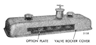

Most 1970's and newer Detroit's have emissions data plates/labels attached to the valve cover if someone hasn't removed it. That would contains much of the pertinent information about how the unit came equipped from the factory.
If it's a V block, the engine serial number should be on the left side of the block as viewed from the rear.

Here is a serial number chart for Detroit Diesel and Grey Marine and where to look.
