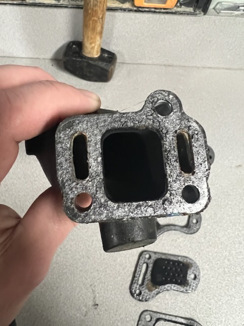

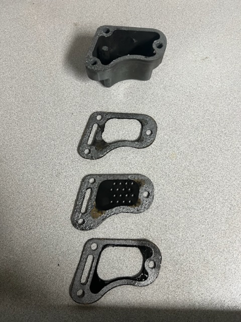

C6545271-02D9-4CAD-B6CE-87798954FD0A.jpegWell I finally pulled this old girl out of project purgatory…

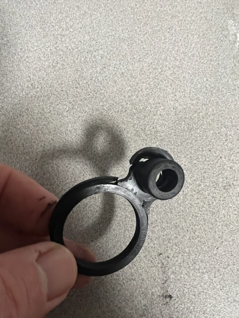

Got the power head off. Pulled the exhaust pipe and other exhaust components apart. It doesn’t appear to be obvious where this leak is coming from. Can’t see signs on the existing gaskets of leaks on the perimeter. However the seal for the exhaust pipe and water pipe was cracked before I pulled it out…
Anyone know exactly what gasket I should be looking for? The two on the exhaust chamber are no longer available so I would have to make them. Trying to find the others somewhere but no luck yet. It has to be one of these three:
Exhaust manifold gasket
Exhaust chamber gaskets x2
Exhaust pipe/water pipe seal
