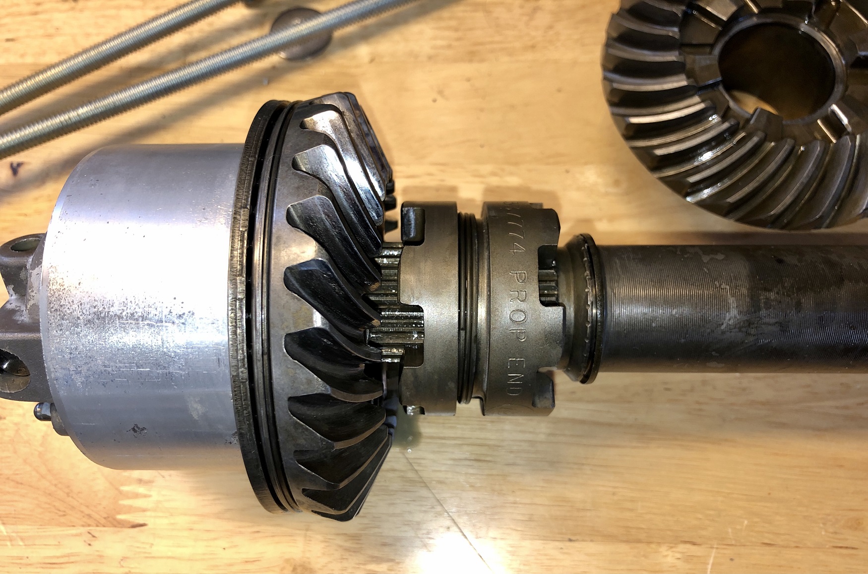

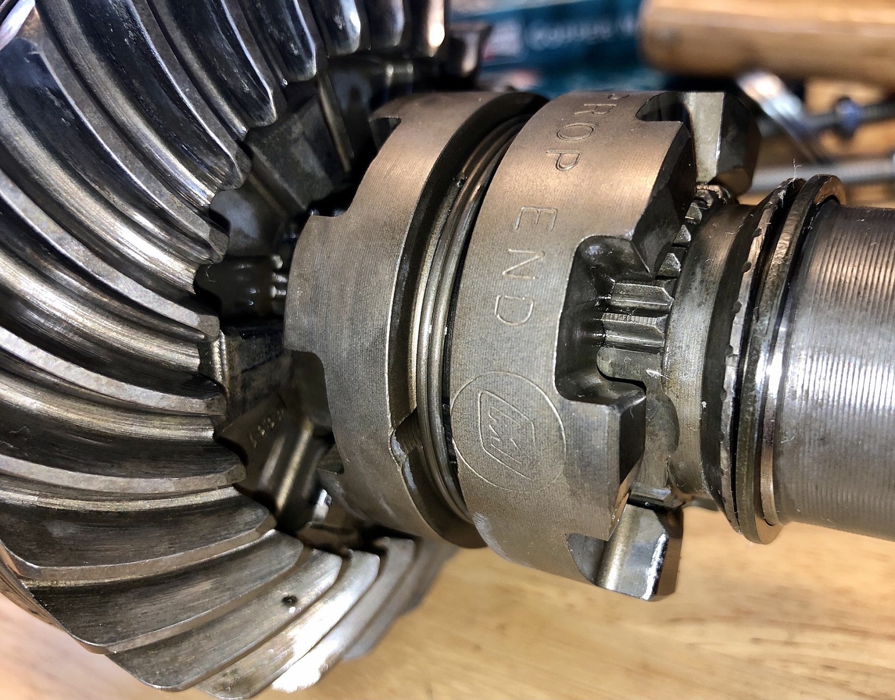

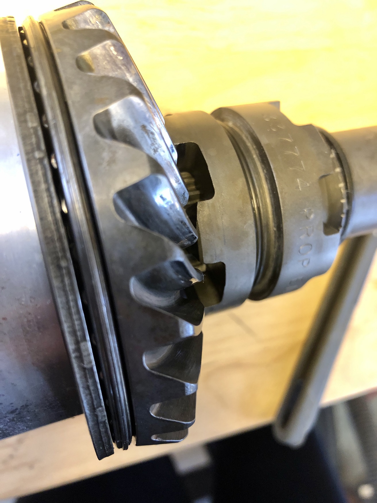

Issue: Reverse engagement is temperamental either not shifting into gear and free revving or grinding then dropping in. Forward is never an issue and it does not pop out of gear.[FONT=&quot]
[/FONT]
I currently have the lower end off and the gears pulled. I suspected a dog clutch / reverse gear issue but after getting them out the gears look acceptable to me, can anyone confirm? I didn't see any shavings in the lube but it was not easy to see as I had an oil/water milkshake.
The shift rod was very stiff passing through the cover and o-rings. I broke the shift linkage at the block a couple seasons ago and I now suspect this was the cause. Could the stiff shift rod be causing the shift issues that I am having?
Thank you!

Yes------Corrosion products build up in the cover and jam it.--------I do not believe these gearcases are as good as earlier ones.-----I am seeing early signs of gear tooth failure on forward gear.----More pictures of tooth surfaces would help diagnosis.----Clean shift rod cover bore.------Install seal kit.----Set shift rod height on installation.

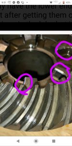

Agree. The reverse gear is starting to round off. Not very good, but still adequate. You gotta make sure it's going into gear right away....not "grinding". Many operators think that they are doing good by "sliding" it into gear....NO!

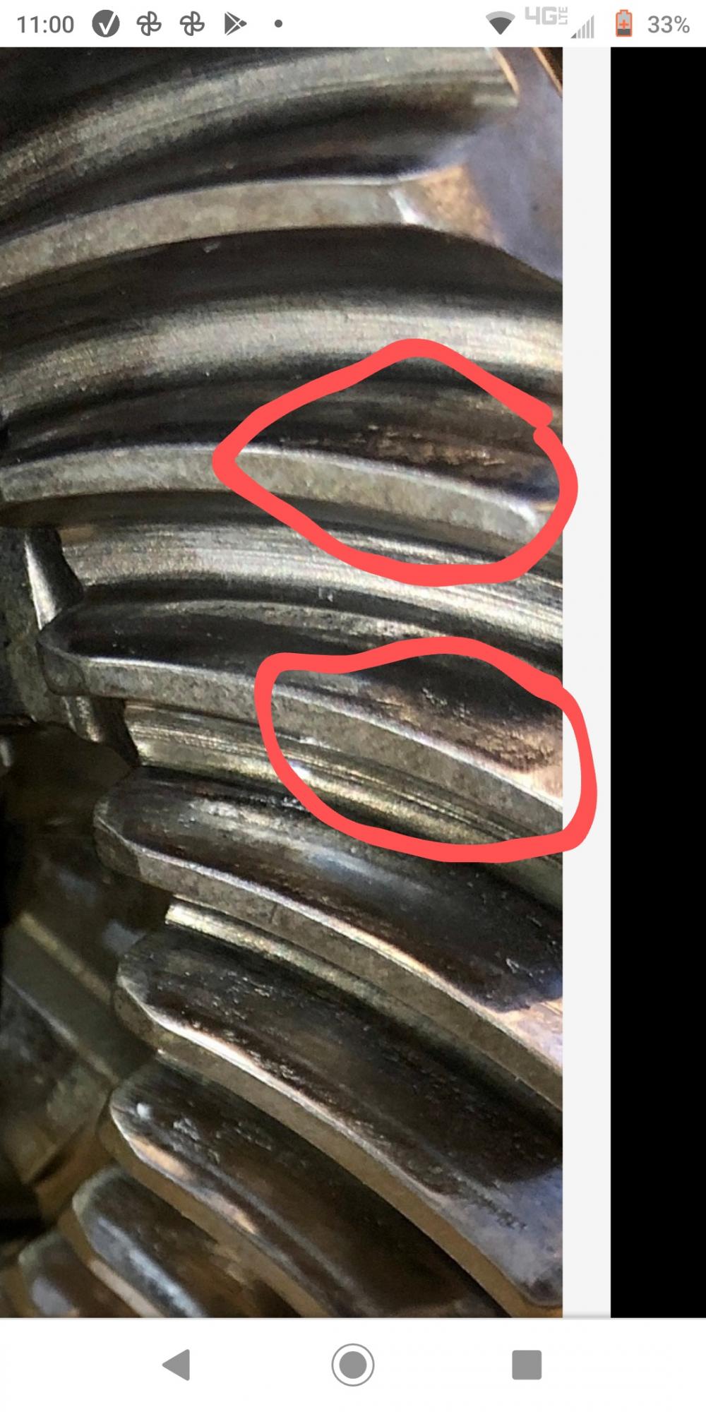

Here are a couple more picture of the forward gear. I think I am going to freshen up the seals and put it back together to see if I can get some more life out of it. I put very few hours on it.

In my opinion these new style gearcases are not standing up like the ones from the 1980's.----Gears suddenly fail on them.-----So run it till it goes -----BOOM---I guess.
Agreed. Nice crisp photos, very clean parts. They don't make stuff like they used too. Engineers now are making stuff to last "just long enough", and not engineering to last for a human lifetime......or even more. Put a little fine sawdust in it....like the old timers did with transmissions. Ha!
Seriously, you will likely hear a progressively louder harmonic before "she blows". Keep a keen ear and check gearcase lube often.
