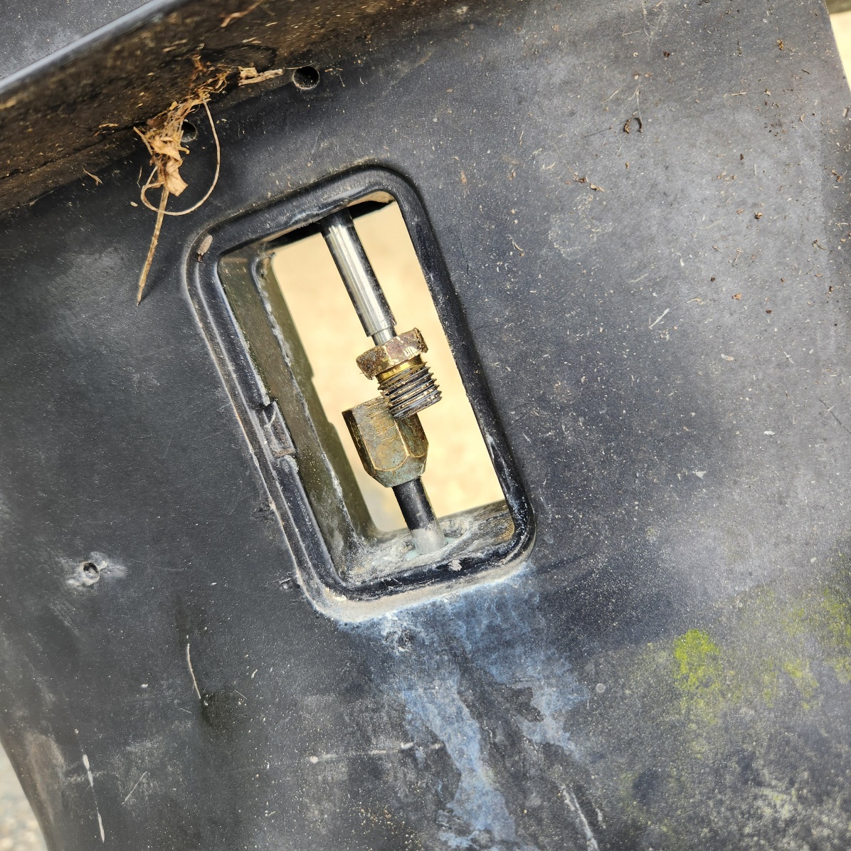

I have the shift rod separated and the 4 bolts and 1 front nut off. Lower unit ony moved hair (1/16th inch) at rear and seems stuck completely at the front where the stud and nut are. Soaked stud with Deep Creep and then with Lime Away. Any ideas greatly appreciated!
Is the paint scraped off on the shift rod? Are the keeper and nut removed? May have to use a little pressure to remove it.
Yes. I used a big rubber mallet on the housing and then a hammer and punch on the stud and nut (partially threaded on) and no luck. Could it be a rusty stuck drive shaft? Thanks
Sounds like the DOWEL around the front stud has corrosion holding it.----Use some heat in that area.------Or try and turn that stud at the front.----And if the spline on the driveshaft has never been greased it could be jammed with rust.

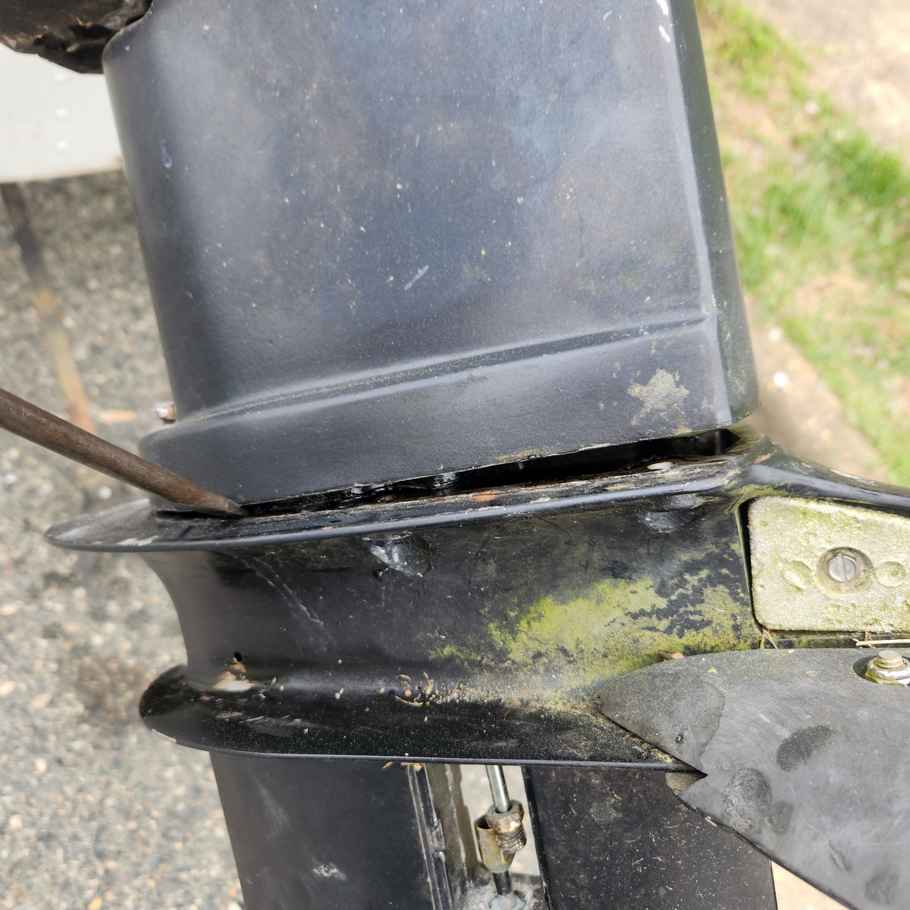

130 top cylinder, 132 psi on the bottom. I got a little to aggressive with the big rubber mallet yesterday and cracked it a bit. Hard spot to get a good straight whack at it. We'll try a little heat and persuasion next.
OK after heating, beating, prying and cussing I now have about 1/8th inch at the stud and 1/2 inch at the back. I believe that the drive shaft is the culprit. Any ideas would be great. Thanks

Your 1st photo looks like you hit the edge of that plate with the mallet. What about using a block of wood…hold it against the metal, close in to the inside edge.
Then you can use quite a bit more force, without breaking that thin edge off.
I did start with a old weak piece of wood and it was just breaking up. I then used a hammer with a hardwood handle and inverted it so the handle was placed on the lower unit and whacked the head of it. After that I just hit it with the rubber mallet. All to no avail. The most movement was from beating on the stud and nut. Thanks for your advice.
The most separation between the lower housing was using a 7/16 12 point socket on a 12" wobble extension placed on the 1/2" nut on the stud and smacking it with a 3 lb. hammer while using various wedges. Thanks
