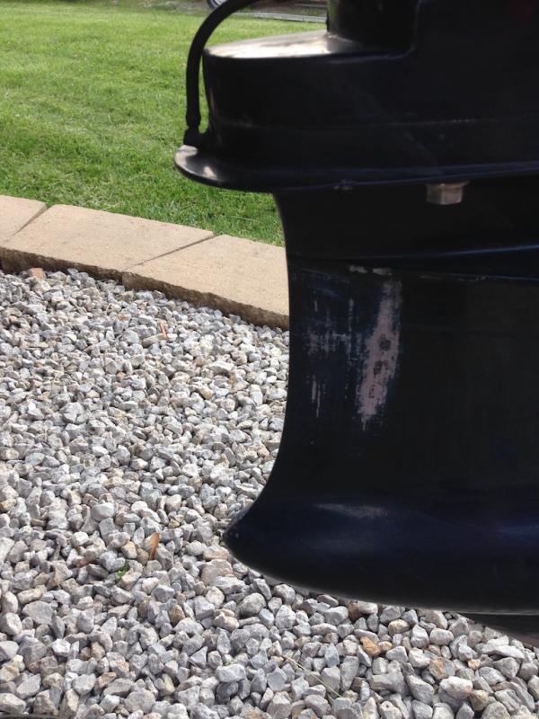

My '96 Evinrude Intruder 150 Model #E150GLEDB has had some issues at times where the forward gear seems to slip at idle/trolling speed. I have NOT seen chunks of metal in the gear oil so I don't think this is an issue of bad/broken gears.

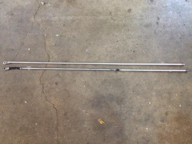

I'm wondering if this lower unit has been off before and maybe they didn't set the shift rod height properly. My guess is it's a bit too high and when it pulls up to engage forward it doesn't quite fully move the clutch dog. I'm going to drop the lower unit this weekend and double check that before I start chasing other things.
I'm certain this is a 20" shaft engine and I think I have the HiPo gear case. I believe the shift rod height is supposed to be 21 1/4" but could someone confirm that for me?
