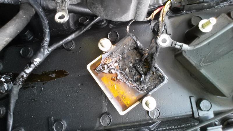

Yes sir. The silicone melted and was hanging. The wires were melted to the but connection. 20140719_115130.jpg

A 19 yr. old regulator...I suspect it just failed. Before replacing it ohm the stator to see if it is in specs. Also do the cable cks. as state above.
