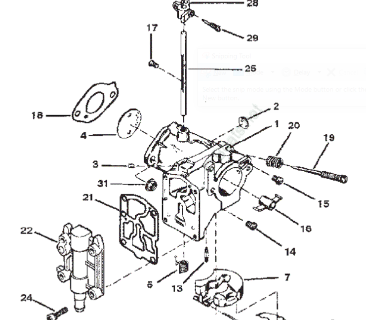

This should be your carb. Make sure gasket #18 has hole in proper place when mounting. Also make sure idle screws #19 are screwed out CCW 1-3/4 turns from light seat as a starting point
Didn’t even notice the hole on gasket so I will check them tomorrow, may I ask what the hole is for?
Screws are set to the 1 3/4 turn out
Hole provides PRESSURE pulses to the diaphragm in the fuel pump.-----Diaphragm is not shown in the above schematic.-----Post the serial # ----Outline your starting procedure.----Are you pushing the key in and holding it in while cranking it over ?

OK well mine had one gasket on way and the other the other way. So one had tab up and to the left one had tab up and to the right. I put them both the same and it didn't make any difference. I reset the lower carb float level I had set it a little high the needle was leaking. Fixed that and reset the float height. Gasket tabs to the left. Still same thing. Watched a few YouTube videos to actually see which way the tab is supposed to be and it's supposed to be to the right so today going to put the gasket to the right and see what happens. Float height correct and gasket correct. Right side as looking at the front of the motor. Like the diagram above. X fingers.
