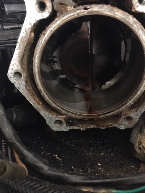

Here's what I found when I removed the port side head. The middle deflector created a blockage.

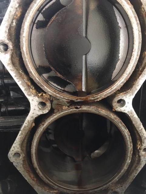

So I took it out for a hard run and it ran like new. Temp was the same at idle as it was at 5300 rpms. Ran at 5300 rpms for about 5 minutes and all was good. Water pressure was 18 psi before clean out and water deflector replacement and is now running at 13 psi at same rpms. Here's a pictures of the starboard side, which was just
s bad, after I cleaned them up and installed new water deflectors..
