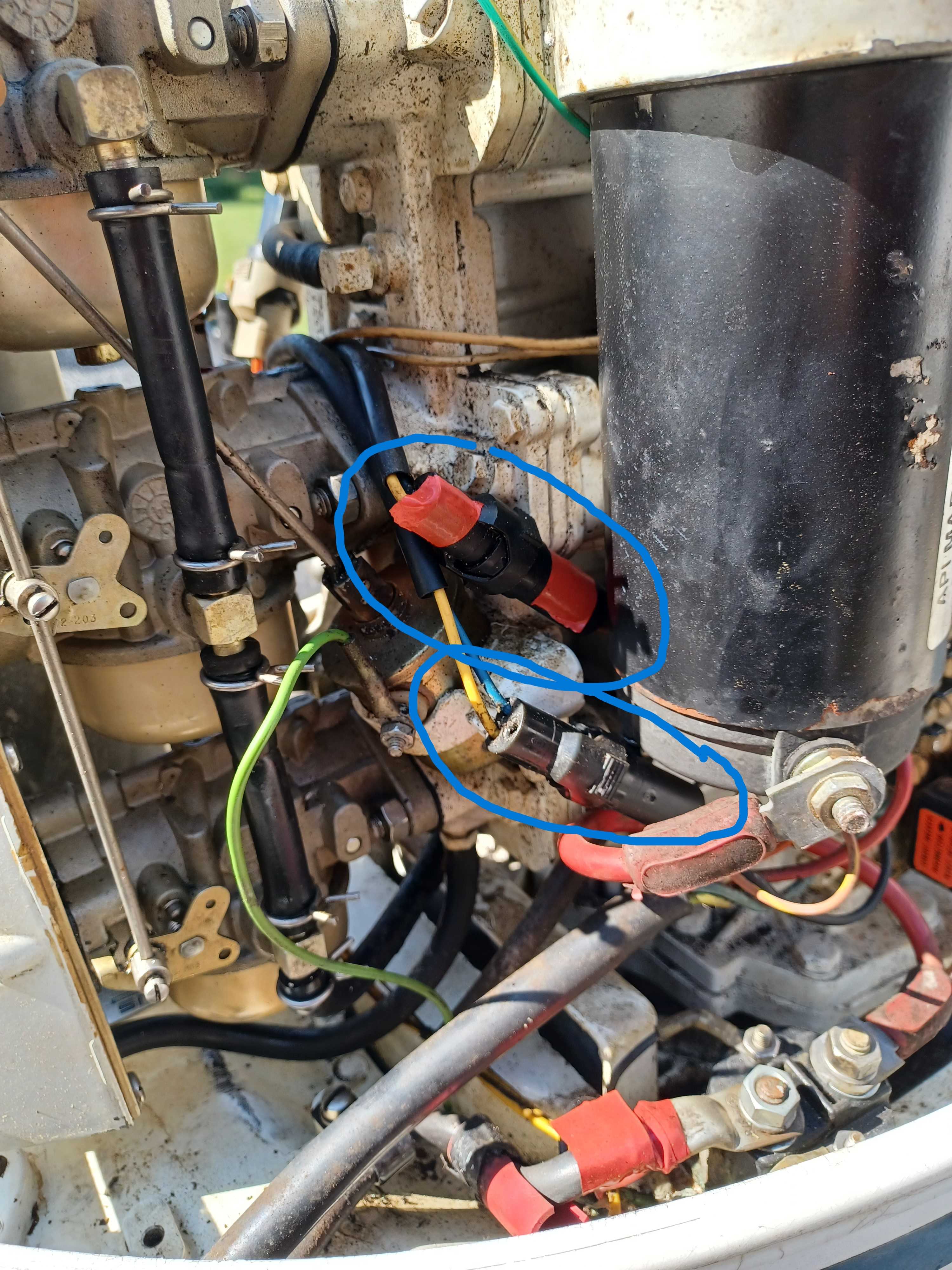

OK, before I blow the whole motor up swapping the packs, it looks like all I would have to do is change the quick disconnects. It looks like there are 2 on each side of the motor. I have pictures but cannot figure out how to post them yet. Says they are too large
Ok, Just had to resize them.
