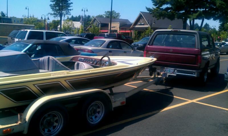

Ok guys, i just bought my first boat, I thought I had done plenty of research, boy was I wrong. I bought an 1982 Ski Centurion by Fineline, its 17ft and has the 3.8 v6 GM with a OMC stern drive. Well, being a GM i figured parts would be available, LOL LOL LOL, dammit, could never have been so very wrong. Had her on the Water for the first time today, ran awesome and drove awesome, not a tick, knock or cough, really runs well, im pretty impressed with the way it runs.. I did let the 4 barrel carb load up a bit and it died once but fired right back up.. My question is, once this bad little chicken gives up the ghost how hard would it be to drop a small block in? will everything mount right up? I hate to throw good money at bad causes so once this goes im going to have to explore options power plant wise, was hoping there was some sort of direct fit as far a motor to replace the 3.8.. Also, it gets up and boogies pretty stinkin ok, the speedo indicated 62mph but i think it was a tish proud by 7-8 mph (ive owned a few seadoo xps, it was 62mph, closer to 54-58)... also any advicr you could give me on this little boat would be so very awesome, it has been very well taken car of but this is my first real boat and im really in the dark.... Thanks in advance guys.. Ive included a few pics of today, brought her into work to hit the water straight from there and finally figured out that sill top once ofcourse i got home and the day was over... :).. HOOAH.

looks neat. If you're in the 50's now don't think you want a sbc. the back of those things sit low enough already.
plus the fuel tank probably isn't huge.
