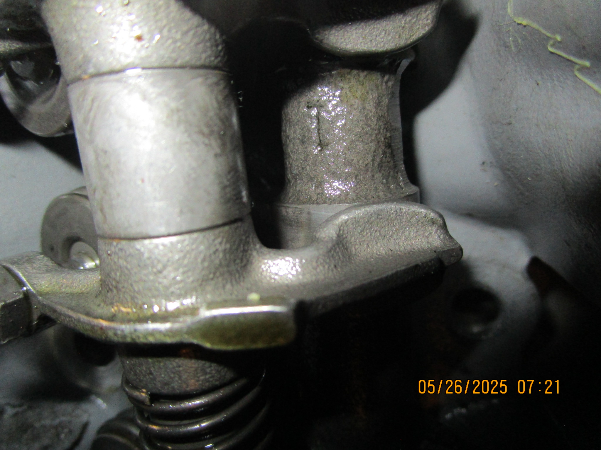

80's 7.5hp cam identification mark.. Is this it?
rocknroj
Here's a pic from a head in my garage..Trying to determine what which I have. The honda repair manual on p 4-37 describes a tic mark identifying a 7.5hp vs 10hp but the graphic is not real clear. This is near the cam pulley side. Thanks in advance for knowledgeable responses. This would be visible if one were doing a valve adjustment or otherwise had the valve cover off.

Hi,
No, that isn't the ID mark in your photo.
The mark on a 7.5 is a single punch mark located on the sprocket END of the camshaft and opposite the keyway.
The10hp has no mark.

Thanks for the info. Checked that location before my inquiry and no mark..
