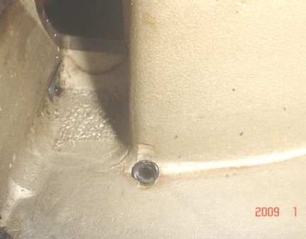

I was looking at the parts diagram and I see there are bleed restrictors... what do these do, and where would they be located on my block?
The labyrinth seals are the machined grooves in the i.d. of the reed blocks. This forms a seal with the fuel/air mix, note that it's not totally air-tight but seals enough to isolate the charges to their particular cylinder.
The machined areas where they contact the crankshaft o.d. should be sharp, and well-defined. If they are mushroomed, then they are worn beyond repair and the reed block must be replaced. Worn reed blocks can cause hard-starting and poor idle.
On the bleed restrictors, they are under the transfer port covers and help idle quality by limiting the amount of pooled fuel that is sucked back into the cylinder. Missing restrictors can cause a poor idle.
See the attached pic for exact location.
Note that you can replace a missing restrictor but you have to be very careful about installation because the plastic restrictors are easily damaged. One way to dispense with that is to peen over the hole, finish with a flat punch, then use a #60 (.040") drill to drill a permanent bleed hole.
2nd method is to thread the restrictor-less bleed hole with a tap, to fit a small Allen set screw. Install the set screw with Loctite Red. Drill the small hole thru the center (you can also drill before installation if you make a jig). Permanent install, it'll never fall out!

the bleed restrictor holes in this block have nothing in them, they are drilled to #31, and it would seem that peening and redrilling for size #40 would be the best method to restrict them. I will do this, although the lower one will a bit more of a challenge due to the angle it is drilled thru the casting.

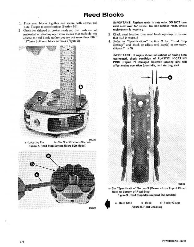

another question I have concerning the reed valves... when looking at them with a magnifying glass, I can see some that are slightly open, and when I touch them they will close, but will spring back open just a hair.... is this normal or does it matter much?
Im thinking there may be some dust/debris at their base that is holding them open, but im not sure how important it is to have them all perfectly closed at rest, or if they do their job fine as they are... Thanks
If it's just a bit of a wiggle, that's OK. Invariably if they're badly worn the i.d. will be mushroomed.
It's ok for the reeds to be off the block just a hair (factory spec is .007"). They will still close against the reed block at the appropriate time.
What you don't want is a reed that's bent and forced into the block, because they won't open properly. Caution DO NOT flip any reeds over because they are guaranteed to break. The manual says zero preload is desirable, but also says a very small amount of preload against the reed block is acceptable. Sometimes residual oil will make the reed stick to the block. You could clean all that out with carb cleaner spray. If you gently press against the back of the reed you can get a pretty good idea on how much spring there is, back into the reed block.
none of the reeds are bent away from the block, and even gently blowing on them will close them against the block, so im sure they are fine...

HTH..........ed
I have just re-read this... I see thet the restrictor holes should only have a .040 opening, which is a #60 drill size.. thats a LOT smaller than the manufactured port opening of drill size#31, and also much smaller than the #40 that I had originally thought I read in your reply.
ive tried the peening technique, but as the aluminum block seems to be a harder alloy than an automotive block, its tough to peen.
I think what i will do is open the hole slightly so it will snugly accept a 1/8" brass rod... then bore the #60 hole thru the brass rod on the lathe, and cut the rod into short plugs that i can insert in the 1/8" holes... and peen the aluminum to insure the brass will never come out..
That would probably work, too. I dug further into my archived material and found that the person who did the mod used an 8/32" stainless allen setscrew with the hole drilled in the middle.
If you make a machined insert, be sure to secure it with Loctite Red or other hi-strength Loctite such as Bearing & Stud Mount, as well as peening over. The Loctite will make a sure seal between insert and block.
