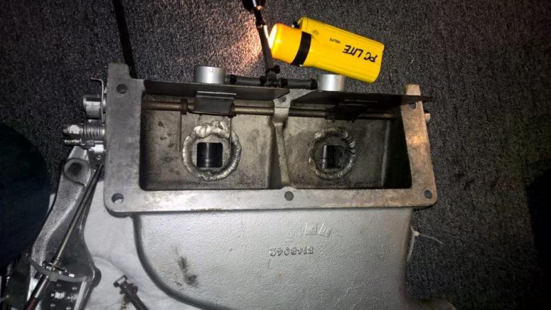

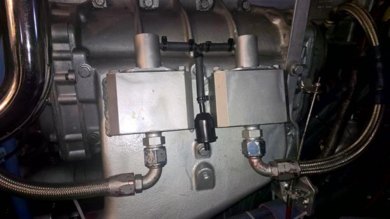

Back at the boat and found/figured out where the bypass valves were. Removed Air Box Door Housing to inspect orientation of valves. Valves were closed, unclear to me how to service so I reassembled hoping that the valves closed during disassembly. The Engine started right up. So I am assuming that the valves had stuck open and had closed somehow since then? Any ideas on how to service these?

This may sound dumb but where do the two large braided lines lead? Are they the "bypass" lines going to the air box? I've never seen a bypass setup like this. If the air inlet from the turbo is just out of the photo on the bottom, then that must be how this is set up. I believe it is a system that would also act as a "waste gate" to prevent over pressure. I think that is what that black check valve looking thing is that you can see between the two "boxes"
OF COURSE, it was built by someone smarter than me. So, I have to say, that if it works as I think it does, it is pretty ingenious. Only one problem.....
....One reason I would see that would make it superior to the internal blower bypass is that it looks as if when the bypass valve(s) stick...the engine should still be able to start!!
I mean, it's all located on the inlet side of the blower.
Although, I suppose that if the valves hung open, then that would allow the blower to sort of "feed itself in a circle" by pumping air to the airbox but then drawing the air right back out of the airbox!
BUT...wouldn't a couple of check valves solve THAT problem?
Do those braided lines HAVE check valves associated with them? And, if so, could THEY be stuck open too?
This is all speculation on my part but, like I said, I would TRY and help you figure it out.
As far as servicing those pistons....do I see bolts holding them in? Couldn't you just unbolt them and slide them out?

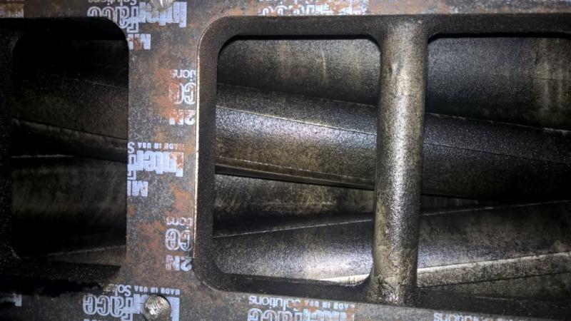

You may want to check the turbo compressor wheel seal. It looks as if the rotors are getting good and oiled up. That would be turbo seal or it could be the blower rotor seals are weeping a bit. But it looks like it is coming from the turbo because the box looks wet and that would explain why the valves may be sticking open.

So the ends of the braided lines we do not see in these pics, they go directly into the airbox, or the airbox side of the blower? And at a certain boost the valves open and boost goes "around" the blower and directly into the airbox? If so then I understand the no start. Never seen this system before and I can't see all of it now, so I have no idea how to service it.
Seems to me that the four bolts....one on each side of each valve....come out and the whole shebang is in your hand in about 2 minutes.
Is it simple? Pistons with springs holding them closed until boost pressure
from the turbo shoves them open ?
Maybe just gummed up from too much oil.
Yep, that's the way it was on all the V engines I worked on. Only we found that cleaning them wasn't always reliable. We learned to just put in a new valve in place of one that was sticking. Although, if I would have had my ultrasonic cleaner back then, I would have given that a try first.

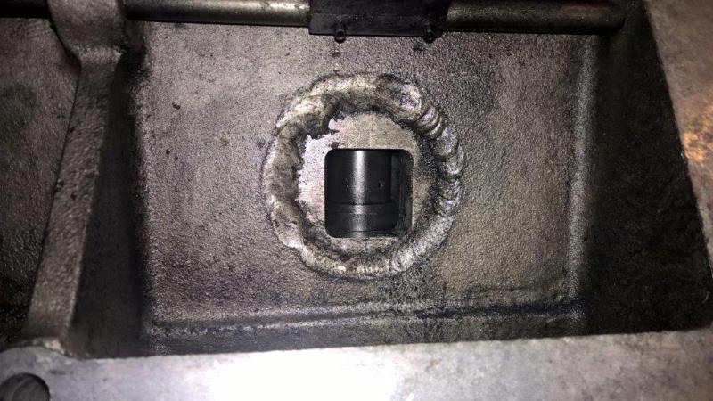

When removing the bolts that appear to hold the valves in I could see sealant, there are also flats that must be for a large wrench, was afraid to monkey with it, but may have to, or if I remove fittings on bottom can I access that way? I will check.
jgmo, I agree with your assessment of the braided lines, I do not think they have check valves, what type would I add? Also agree that it must have stuck and recirculated, it is all I could come up with.

You may have to take the whole air horn back off to get the valves out. I don't see the large flats you're talking about but that might just be the material they used to fabricate this rig. Just don't force anything and I believe you will have good news for us in a bit.

Here are some close ups of the valves, searched online for the part number you see on top and the eBay item came up. Looking at the eBay item and the sealant, it does not appear these are treaded in. Not sure how tough the sealant is but looks like I could do damage removing them. But not sure they are even an issue, see below.
Update, the bypass valves are closed and the engine was hard to start again. Cranked for 5 seconds, waited 15 seconds, cranked again for 5 seconds and the fog came out the air box drain again! Stopped, went and beat my head against the wall, then turned switches off at helm and back on again. Went back to engine room, started the "good" Starboard engine, 1 second crank and she's running. Let it run for a few minutes, then started Port engine, it cranked just a few seconds and started up.
So, could I have a bad switch or, one of my theories is that this problem on the Port engine could be because it is farther from the batteries then the Starboard. The Batteries are on the outside of the Starboard Engine so likely 6' of battery cable closer. Wondering if the Port is not cranking fast enough to start. Connections on Engine look great, starters look like new. I need to look at battery connections and see the route of the cable, the cables are very heavy gauge, there is also a battery combiner in the system as well.
