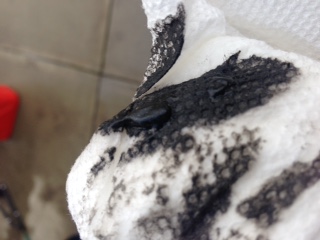

I also attached pictures of the oil mess after it has run.

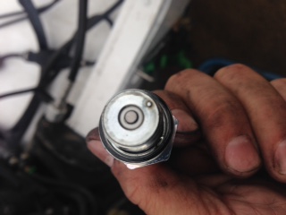

The top plug looks normal, the other 2 look abnormally clean. Like they've been steam-blasted from a water leak. In fact, is that a water droplet I see on the 2nd plug?
The gloppy goopy mess you see is not indicative of what's happening in #1 cylinder. It's coming from unburned fuel/oil mix, mixing with water.

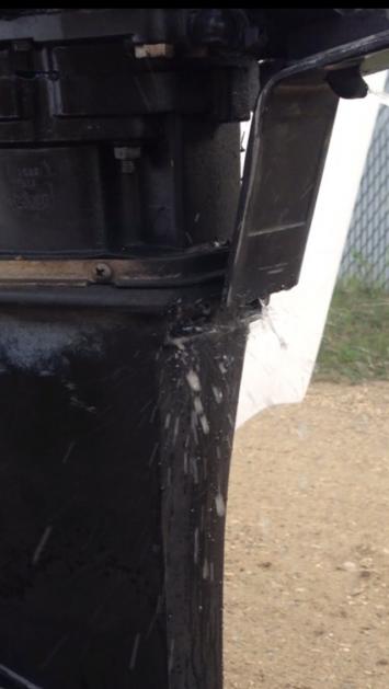

Now that you mention the water in there, I have good flow out the cooling hole but also see water trying to spray out of the exhaust at the top of the leg (tried to take a picture of it). Not sure if this is normal or not.
imagepng
The water dumps down the leg, and some is taken up into the exhaust reliefs. This is normal. You'd see more water coming out of those when you're in the water, since you have some exhaust backpressure.

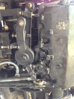

Any other thoughts. Also the idle set screws on the side how does a guy know where to set them?

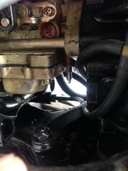

That's a good sign when the rpm came up. But I doubt you'd see much difference in any of the plugs after only a few minutes of idling. You'd have to get it out on the lake for a full power run then read the plugs afterwards. And Permagap plugs are notoriously hard to get good readings off of.
The carb drip, if it's doing that when it's running, is definitely a problem. Mostly a fire hazard but then you don't want that fuel/oil mix dripping all over anyway.
Might be some "fluff" in the float needle, a maladjusted or "sunk" float, many things can cause that. A large leak might spill out of the carb throat, and one like that would definitely make the cyl's run rich on that carb. Might also mask the results of a drop test.
So you might need to get that issue under control before running. Or run it a bit and see if it works itself out.
Far as carb adjustment goes, you have to set the idle speed and mixture in the water, warmed up & in gear. Adjust each carb idle mixture needle for smoothest idle. Then try a fast takeoff and if it stumbles, turn each carb needle 1/8-turn rich (CCW) then see if it'll accelerate. If not, try another adjustment. It'll end up idling a bit on the rich side (i.e. "lumpy") since these carbs have no accelerator pump and if you run 'em Lean n' Clean, they'll bog on takeoff. Just a compromise.
One last thought, after you've run it a bit, turn it off and feel the metal base of each spark plug. They should all feel quite warm (or Hot!) and if you have one that's drastically colder than the others, it's not pulling its load. If they're all nice 'n toasty, that's a good thing.
Anyway, see if any of that helps and let us know how it goes........ed

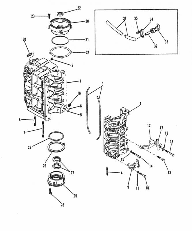

I also went out to the part area of this site and looked at the crank case breakdown. The top seal was item 22 and the lower seals were item 27. There was no listing for item 22, did I miss something? Do you use item 27 on the top and the bottom? A discussion of replacing the top seal would really help me.
I have a 50hp 1990 Triple which is pretty much the same motor as your Mariner. All the crankshaft seals are the same. On the diagram for my 50hp, the P/N for the upper crank seal (22) is listed, whereas number for the lower crank seals is missing. Go figure!
I wouldn't be too suspicious, though, of a top seal unless it's leaking oil under there. They don't seem to go bad as often as the lower seals, which are subject to much more strenuous conditions.
At any rate, the upper bearing cap is a snug fit in the crankcase but will pull out without splitting the case.
You need to use some sort of puller on the cap since the mounting "ears" are quite fragile and could be easily broken. The cap will pull straight up, out of the upper crank bearing & crankshaft.
If you do pull the cap, you also need to replace the O-ring. Lubricate the O-ring with some Mercury multi-purpose grease or light lithium-based before reinstallation.
Make sure you mark the cap for proper orientation. As I recall you can only bolt it up one way anyway, but you might as well start out having it correctly aligned before you reinstall.
