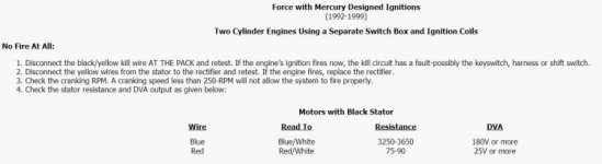

I've gone to outboardignition.com and tested according to these steps at the top of the screen except for step 3 because i'm not sure that's even possible without any sparks and step 4 I don't know how to test these with the stator still on the engine. (and I don't have wires of those colors)

The plugs still wouldn't spark after removing the yellow wires from the stator or the kill wire. This along with the knowledge of all of the other parts that I know are getting juice leads me to believe it has to be either the stator, trigger, CD module, or ignition coils. Is this a correct assumption? If so how can I test further? I would like to test the stator and trigger without removing them since I don't have a puller or even a wrench large enough to remove the nut at the top of the flywheel, but I'm not sure if that's possible. Are there any other tests I can do so I can know more specifically where the problem is coming from? Below is a picture of the CD module and ignition coils. Let me know if you need more pictures. Thanks!

Disconnect kill wire AT THE PACK. "white wire on the bus bar"
Check for broken or bare wires on the unit, stator and trigger.
Measure DVA voltage of the stator between the output wire sets. With everything connected, readings should be approximately 180 volts or more.
Check the stator resistance, you should read 680-800 ohms, DVA 180V or more from blue to yellow
(Note - On some two cylinder engines, the stator has Iwo blue wires and no yellow wire. The stator will read from blue to blue). All stator wires should read open to engine ground.dings between the stator wire sets range from 680 - 800 ohms.
Disconnect the rectifier. If the engine fires, replace the rectifier
Check stator and trigger resistance, trigger wire sets read approximately 50 ohms between the wire sets (DVA-5V or more), stator reads 680-800 ohms, DVA 180V or more from blue to yellow.
If readings are good, disconnect kill wire from pack. If the dead cylinder starts firing, the problem is likely the blocking diode in the other pack.
