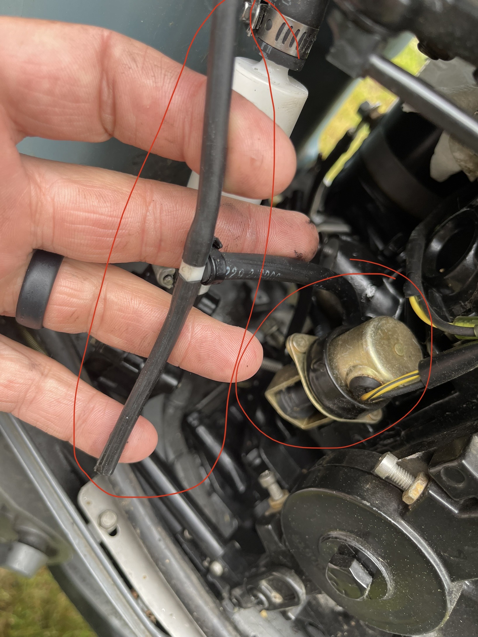

I have a 40hp magnum 4cyl 2 stroke, the compression test results were as follows
#1-94
#2-99
#3-97
#4-105
These numbers seem low, am I correct in thinking that. The motor seems to idle very well but stalls when put in forward. I also discovered that the carbs were both leaking, and the top carb vacuum line was broken off and not attached.
I will have to get another one, the one I’m using is from o Reillys auto parts. Any suggestions on where to get a better one?
Also do you know if the vacuum line would cause the engine to stall when put under load?
What ----Vacuum line---Was it a hose from bottom of the float bowl ?----Open low speed mixture screws 1/8th turn at a time out oon the water.-----Often that will make the stalling go away.
